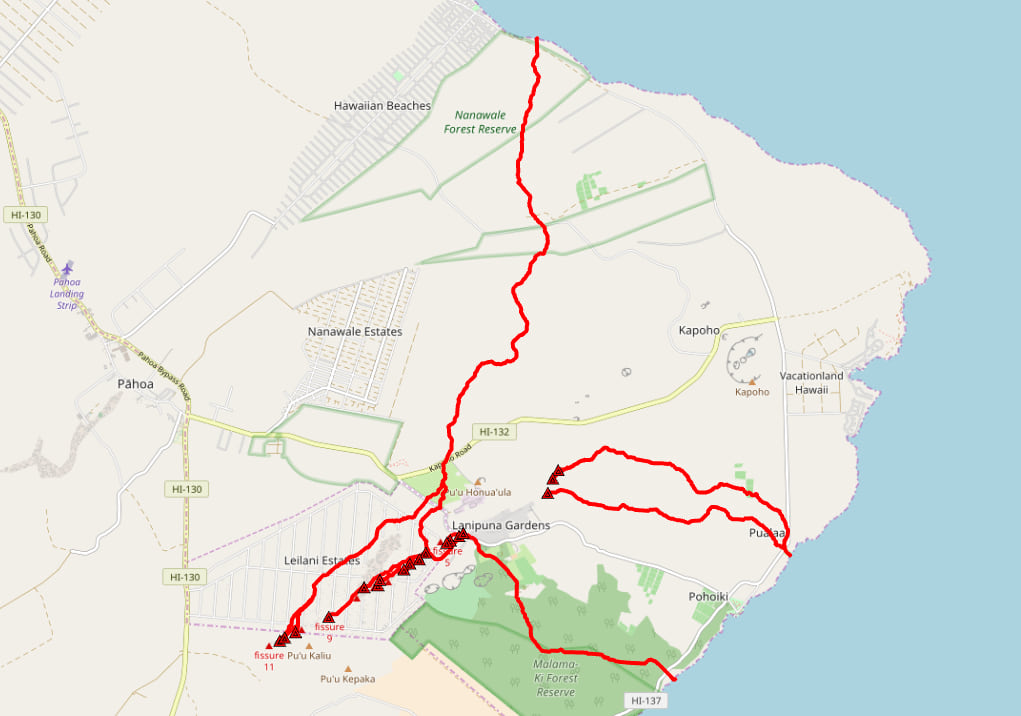

Next I added the server hydro.arcgis.com to my catalog pane and used the trace downstream tool to find the lava’s path to the sea. (The trace downstream tool consumes credits.)
My analysis found that the lava will be heading from the fissures in three directions: North, East, and Southeast. And it has the potential to cut off a whole portion of Puna District!

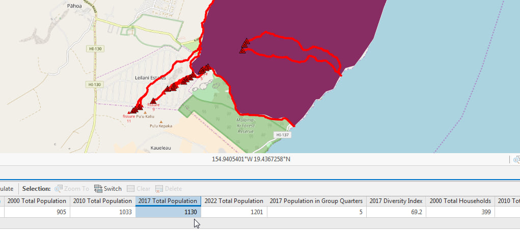

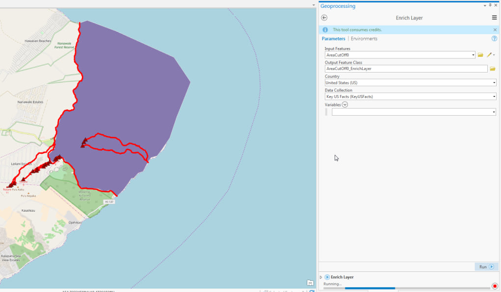

Next I wanted to find out how many people live in this area of Puna. So I drew the area and ran the enrich layer tool.
From my estimate, 1130 residents of East Puna would need to be evacuated from the area if it were cut off. There are 765 total housing units in this area. 162 are occupied by renters and 226 are considered vacant, so there may be a few hundred more tourists that need to be evacuated as well. Good thing the lava moves slowly and Hawaii Civil Defense has helicopters ready to go.
