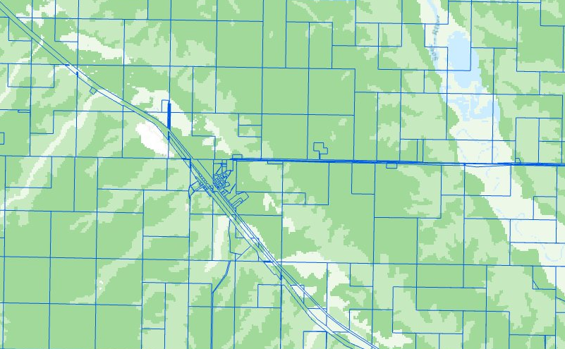

To show you just how easy it can be to work with Living Atlas Layers in ArcGIS Pro, we shared a step by step tutorial comparing crop productivity ratings per parcel that you can follow to successfully aggregate soil information to your parcels. The tutorial makes a useful guide for any of the SSURGO soil layers.
Learn how to add soil layers to your map and calculate an average crop productivity rating for any farm in the 48 Contiguous States. The rating makes a useful comparison of crop productivity in your local area.
