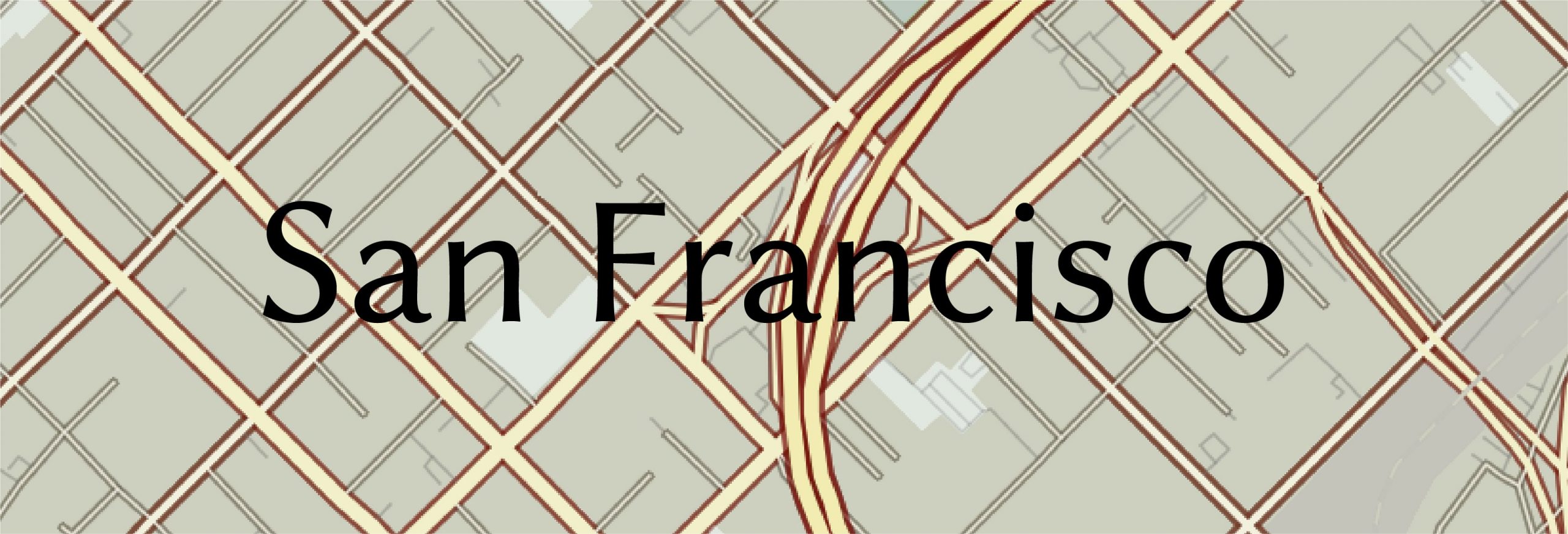

Here is an example of a label over a busy and intrusive background. This is adapted from the National Geographic Style basemap:
The San Francisco map label over a strong street pattern.

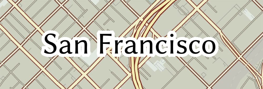

And here it has a blocky white halo – the sort that I hate so much!
The San Francisco map label with a broad white halo

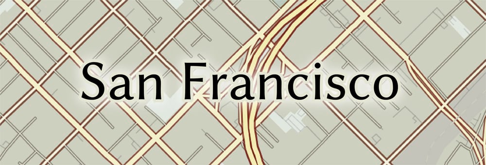

If you are working with vector tiles there is another tool you can use. Open your map into the Vector Tile Style editor, choose a label, and look for the font settings. You will find halo color, width and opacity (opacity is the reverse of transparency – the lower the opacity setting, the higher the transparency), but you will also find halo blur. So now we have another option – Use the blur setting to soften the edges of the halo. Experiment with adjusting the width of the halo and the blur value to find a good combination.
This example has a slightly lighter version of the background color with a blur
The San Francisco map label with a blurred white halo
