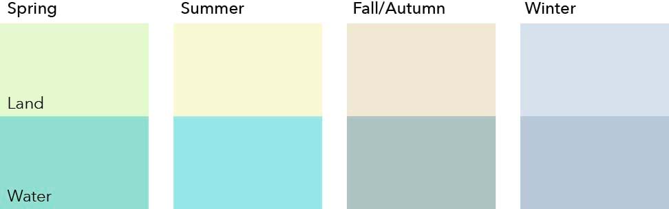

Adjusting the style is relatively simple using the VTSE. In this exercise I established the overall appearance of each new map by changing colors for land and water (using the ‘edit by color’ option). These are the starting palettes for my 4 ‘Seasonal’ maps:
Once I had something I liked, I started work on the rest of the detail (remembering to do that at all scales). This is where the bulk of the work was done.
