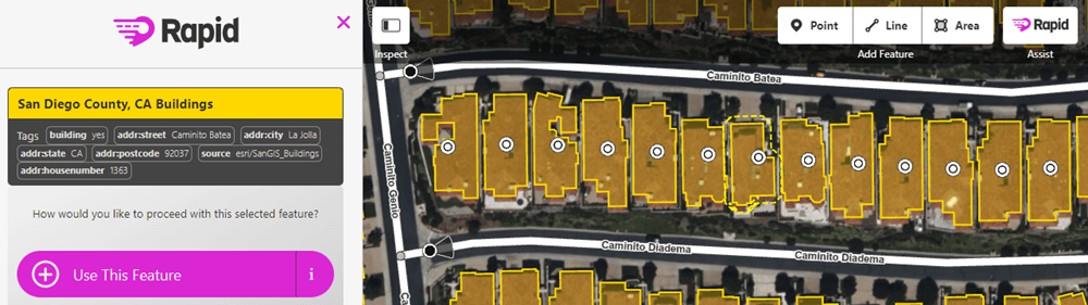

Three years ago, we introduced ArcGIS Data Support in OSM Editors, including Rapid. This collaboration with developers at Facebook (now Meta) made it easier for OpenStreetMap (OSM) mappers to access high-quality GIS open data while editing OSM. Since then, we have enabled access to almost 200 ArcGIS Datasets in OpenStreetMap representing over 100 million features from the ArcGIS user community!
Last month, Esri attended State of the Map US to talk about this work and the ways in which OSM data can be accessed through ArcGIS, including new 3D Basemaps. We also supported presentations by Meta developers on recent enhancements to Rapid, and the process for “Adding Data to OSM through Esri.” During the event, several attendees inquired about how they could work with GIS organizations and data to help improve OSM data, which is the focus of this article.

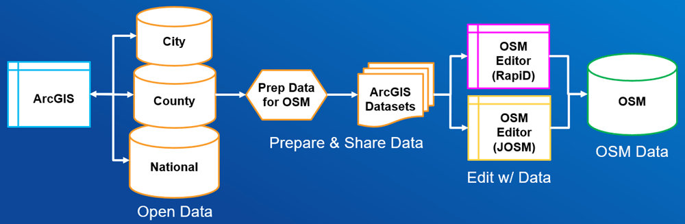

In presentations at both Esri and OSM events, we have described the process for sharing ArcGIS datasets with OSM through editors such as Rapid and JOSM. The diagram below illustrates a data pipeline from ArcGIS to OSM.
Many organizations at the city, county, and national levels use ArcGIS to create and manage their GIS data, and to share select datasets (e.g. buildings, roads, addresses, etc.) as open data for use by the public. This open data is prepared for OSM and published to ArcGIS Online where it can be accessed in OSM editors and manually added to OSM by mappers.

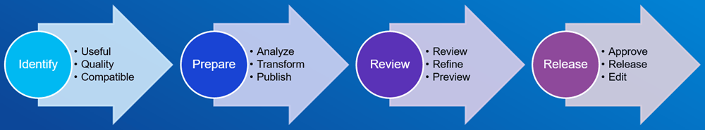

Now let’s talk in a bit more detail about the specific steps involved in this process. OpenStreetMap has a set of import guidelines for performing bulk imports of data to OSM. We have adopted the relevant parts of these guidelines to support this assisted mapping workflow. The 4-step process is illustrated below.
Because the first two steps in the process are most relevant for the GIS community, we will focus on those here. The final two steps are more likely to be performed by Esri and others in the OSM community.
