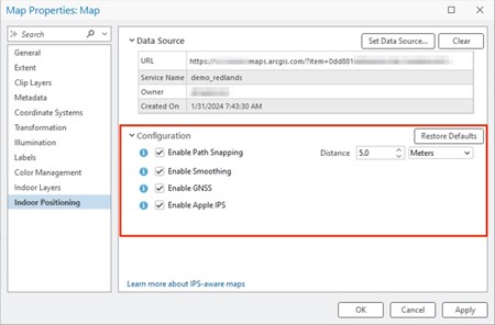

Indoor Positioning Configuration
A new set of configuration options has been added to the Indoor Positioning map properties for IPS-aware maps. You can now manage key features of the IPS engine, including path-snapping, position smoothing, fallback to system GNSS, and Apple IPS support (if available in your indoor environment).
The Indoor Positioning Configuration options become available once you make a map IPS-aware by selecting an existing Indoor Positioning Data Service for the Indoor Positioning Data Source property.
Path-snapping: If your map contains pathways features configured for IPS usage, you can now simply enable path-snapping via the configurations pane and also specify a snapping distance. During position estimations, the blue dot will be snapped to the closest pathway feature within the set threshold distance.
Smoothing: When this option is turned on, it helps smoothen sudden and unexpected position changes to the blue dot.
GNSS: Enabling this property allows the blue dot to automatically switch to GNSS when this source of position is more reliable than IPS, e.g. when leaving the building and transitioning to the outdoor environment.
Apple IPS: I f this configuration is enabled and an Apple IPS deployment is available for your facility, ArcGIS IPS will consider it as an additional source for positioning and consider it while calculating your indoor position.

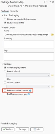

IPS-aware maps can now be packaged into a Mobile Map Package (MMPK) for offline use. The MMPK includes both the indoor map and indoor positioning data, allowing devices without internet access to continue utilizing indoor positioning capabilities. To create IPS-aware MMPKs, use the “Share Map as a Mobile Map Package” tool and uncheck the option “Reference online content”. This update is also part of the ArcGIS Maps SDK for Native Apps release (see bottom of the blog).

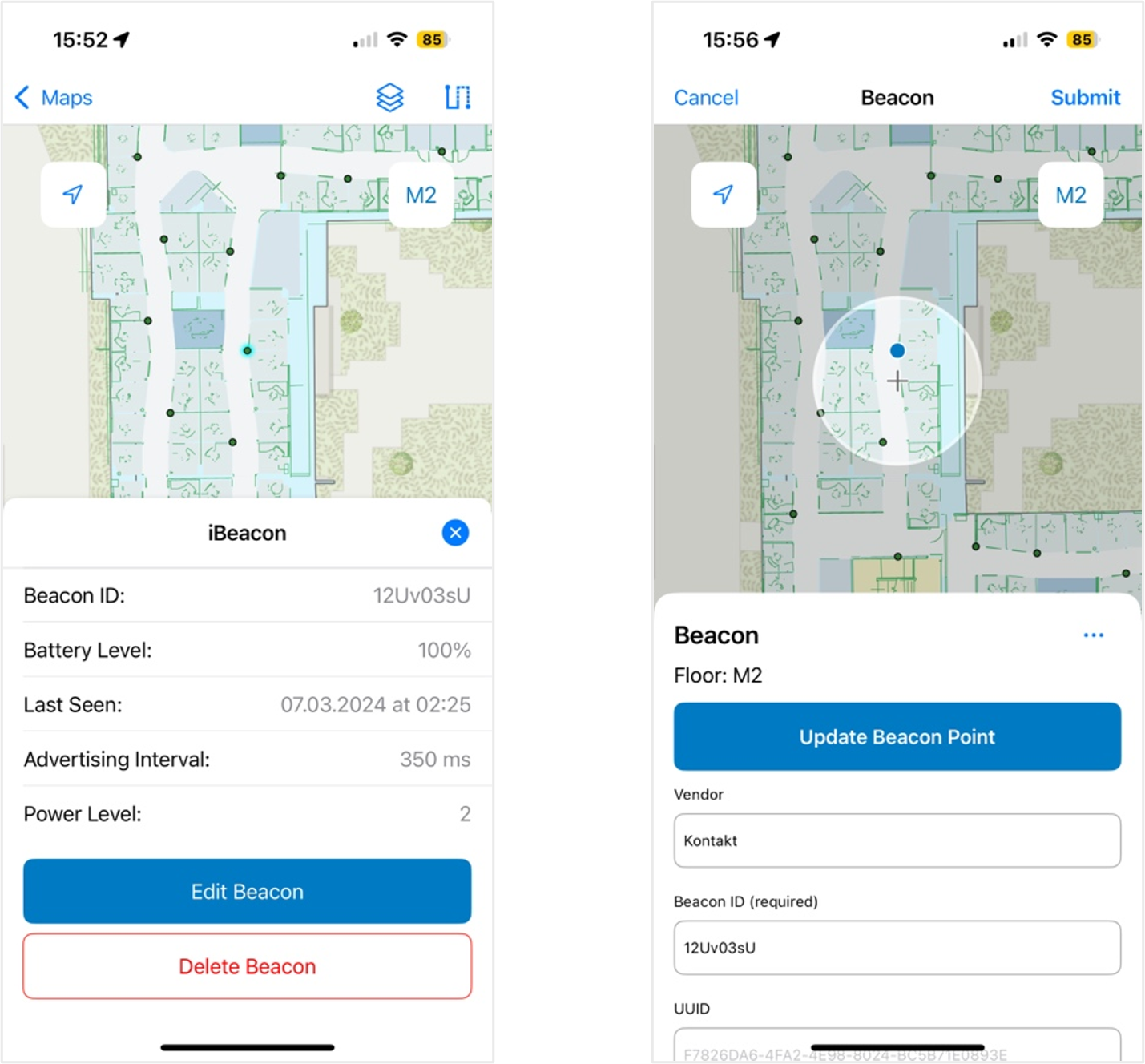

Beacon deployment and maintenance features
Indoor positioning systems typically require some kind of hardware. The majority rely on Bluetooth Low Energy (BLE) beacon signals as input for indoor position estimations. Sometimes, Wi-Fi signals are used in place of BLE.
To capitalize on the benefits of the survey-less indoor positioning data generation method, beacon positions inside the facility must be defined and precisely marked on an indoor map. Aside from the existing option to create and edit features via the ArcGIS Field Maps app’s functionalities, you can now use the ArcGIS IPS Setup app to annotate beacon features through specially tailored workflows. This allows users to quickly deploy and m aintain information about their indoor positioning system infrastructure.
This functionality provides the basis for future capabilities such as automatic health (battery) monitoring of IPS networks.

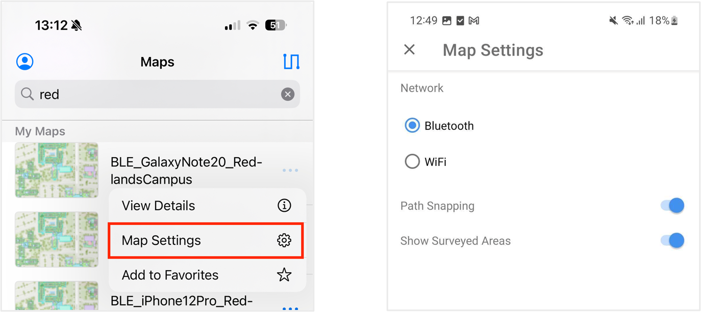

Map Settings
ArcGIS IPS performance configurations used to be handled at the app level within the user profile. The introduction of map settings now allows path-snapping, and network configuration (more specifically – survey radio type on Android; and beacon UUID definition on iOS devices) to be defined at the map level allowing more flexibility during IPS enablement and testing. While IPS configurations can be defined in the indoor positioning map property, IPS Setup users will be able overwrite or customize them in map settings for specific conditions testing.
