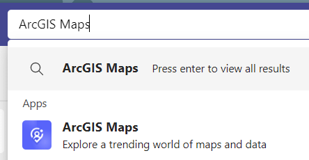

- For a private installation, search for and open ArcGIS Maps from the search bar at the top of Microsoft Teams.

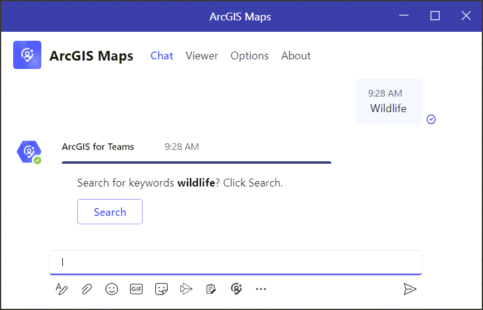

To find ArcGIS content with a search keyword or phrase, do one of the following:
- For a channel installation, type
@ArcGIS Maps <keyword or phrase>
on the channel Chat tab. - For a private installation, type a keyword or phrase on the ArcGIS Maps interface Chat tab.
Your search term can contain place names, topics, or other details.
Tip: Best practice is to keep your search words specific and relevant to get the most accurate results.
A chat message appears asking whether you want to search for these keywords.
![ArcGIS Maps search for Wildlife content ArcGIS Maps search for Wildlife content](https://www.esri.com/arcgis-blog/wp-content/uploads/2021/05/ArcGIS_Maps_Search_Interface-e1660155897473.png)

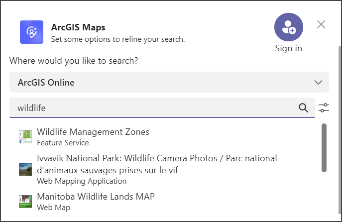

Click Search.
The ArcGIS Maps search window opens. ArcGIS items matching your keyword search are listed below the search term, including the item name and its content type, such as a web map, a feature layer, or a service.
![ArcGIS Maps Wildlife search results ArcGIS Maps Wildlife search results](https://www.esri.com/arcgis-blog/wp-content/uploads/2021/05/ArcGIS_for_Teams_Search_Wildlife.png)

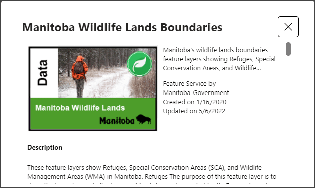

The preview feature helps you to learn about an item before you select and open it from the search results.
Hover over an item and click its information button.
![Hover the pointer over the item name to view the info button Hover the pointer over the item name to view the info button](https://www.esri.com/arcgis-blog/wp-content/uploads/2021/05/hover_over_info-1.png)
A preview of the item card opens, listing information provided by the item owner. This information includes the item name and description, its content type, the owner’s ArcGIS username, and the dates that the item was created and most recently modified.

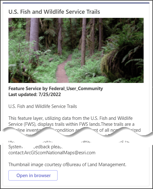

Select an item from the list of search results and then click Post in the ArcGIS Maps search window.
The item card posts into the Chat tab.
![Wildlife service trails card with open in browser option Wildlife service trails card with open in browser option](https://www.esri.com/arcgis-blog/wp-content/uploads/2021/05/Wildlife_service_trails_card.png)
You can copy and paste information cards posted in channel installations to share in other channels—provided that the item’s privacy settings allow content sharing. If the item is shareable, click Card options and click Copy.
To view the item, click Open on the item card.

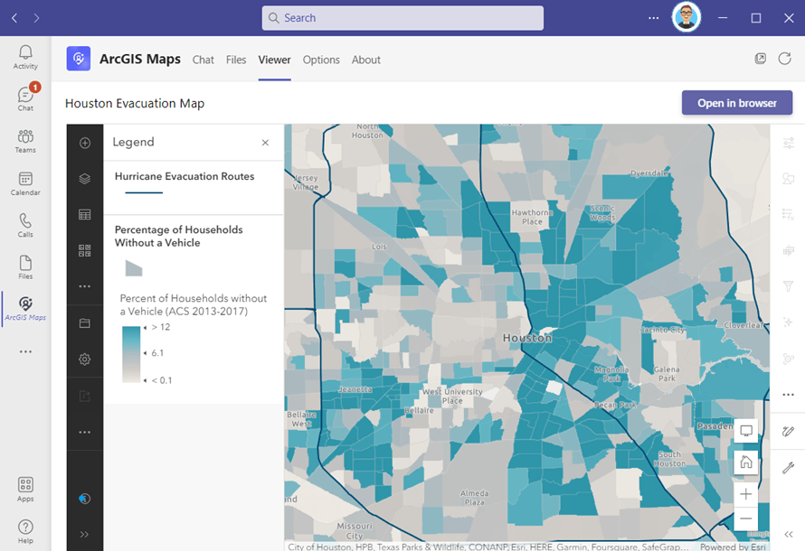

ArcGIS for Teams opens items based on the item’s privacy settings and whether you (and your teammates in a channel installation) are signed in to an ArcGIS account.
- If you are not signed in to an ArcGIS account, most public content prompts you to open it in a browser, in the software native to the file type (such as .csv), or on the ArcGIS Maps Viewer tab.
- If you are signed in to your ArcGIS Online or ArcGIS Enterprise account, content typically opens on the ArcGIS Maps Viewer tab—again, provided that the item’s privacy settings allow content sharing and viewing.
