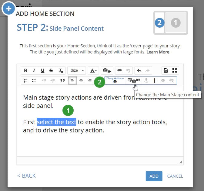

After you’ve added a map to the main stage (see the Story Map Journal Tutorial), you can add story actions to the side panel that interact with the map. Story actions are driven from text links in the side panel. Links can be applied to any text in the side panel, including captions under images.

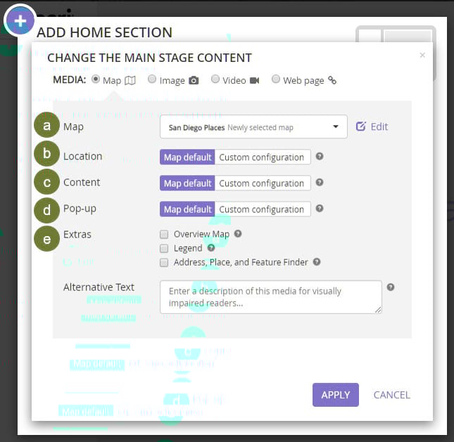

For actions that interact with the current main stage map, first (1) select the text you want to use (this enables the main stage action button), then (2) click to Change the story action tool to Change the Main Stage content.

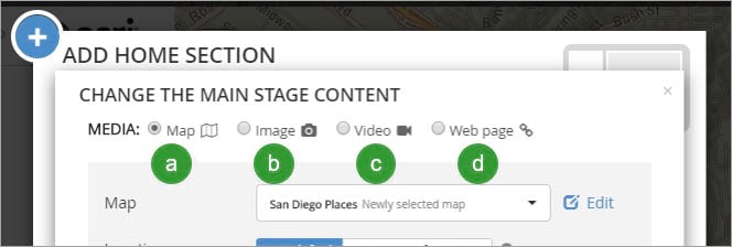

In Change The Main Stage Content, you can
a – Change the the map. This is the default.
b – Set the map location.
c– cToggle the map content.
d – Open a pop-up.
e – Manage map extras, like an overview map, legend, and finder.

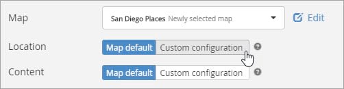

Change the map location

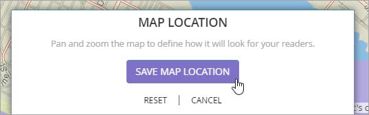

To change the map location, in the Location section click Custom Configuration.
The map will appear, and you can pan, zoom, or enter an address to position the map. When finished, click Save Map Location.

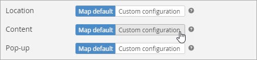

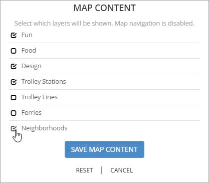

Change layer visibility
To change layer visibility, in the Content section click Custom configuration.
Check the boxes on or off for the layers that you want to display, then click Save Map Content.
When the story action link is clicked, the layer visibility will change as you’ve toggled. The Back button appears at the top of the map; click to return the map to the previous settings.

For all actions that change what is shown on the main stage, (1) Select the text you want to use (this enables the main stage action button), then (2) click to Change the Main Stage content.
In Change The Main Stage Content, you can switch to a different (a) map, (b) image, (c) video, or (d) web page. Map is the default, and the various options are covered above.

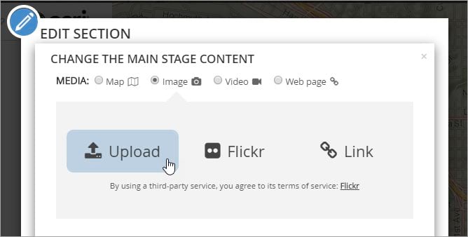

Display an image
Click Image to show the options for selecting an image by uploading a local file, or from Flickr, or a URL. Local files are recommend as these will be automatically optimized for the web, and will be included within the Map Journal. Adding images from Flickr will require entering a username.

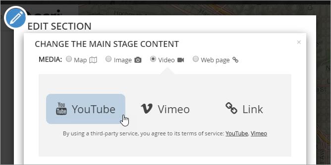

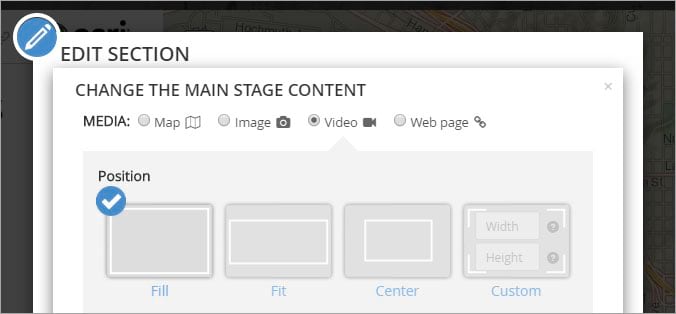

Display a video

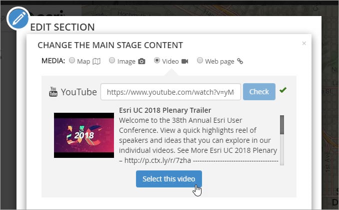

Click Video to show the options for selecting a video from YouTube, Vimeo, or a link to a video source.
When adding a video from YouTube or Vimeo, after copying and pasting the URL click Check to ensure the URL is correct, then click Select this video to add it to your story map.
After selecting the video, choose the Position for the video. The default is Fill, but test other options to ensure best results.

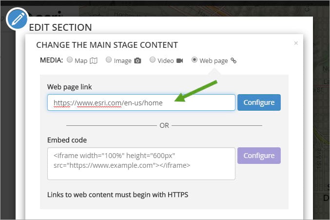

Display a web page
Click Web page to show the options for adding a Web page to the main stage. Copy and paste the web page URL (shown with the arrow), then click Configure. Optionally you can add the embed code for the page.

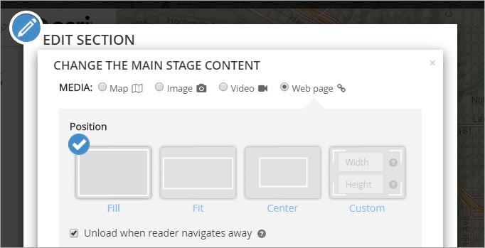

Next, choose the Position for the Web page. For most web pages, especially responsive pages, Fill is the best option. Test to ensure the Position option you’ve chosen is the best choice.
When the story action link is clicked, the specified web page will open. A Back button appears at the top of the map, which returns the main stage to the previous settings.
