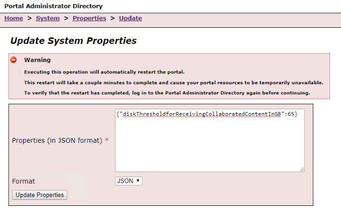

- On the Update Properties page, enter a number (which will be in GB), modified to include your site-specific storage threshold:
{"diskThresholdforReceivingCollaboratedContentInGB":65}
- Confirm Update Properties. The portal will be restarted to allow the update to take effect.
![Customizing the disk space threshold for collaborated content Customizing the disk space threshold for collaborated content](https://www.esri.com/arcgis-blog/wp-content/uploads/2018/07/diskThreshold.png)
