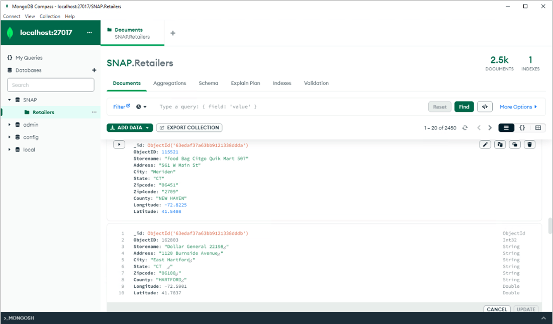

To kick off his demonstration, Shreyas shows the data that analysts in his organization are interested in leveraging: the locations of Supplemental Nutrition Assistance Program (SNAP) authorized retailers in Connecticut stored in a MongoDB database and their business metrics such as ratings, reviews, and price levels on Yelp.
