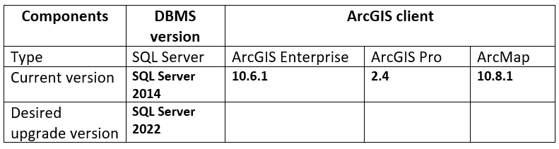

The GIS administrator compiles an inventory with the current client versions in the table below.
Assessment table
Assessment table
Next, they will assess if the current ArcGIS clients are supported with the DBMS version to which they want to upgrade, SQL Server 2022. By performing this assessment, the organization will have a clear understanding of which ArcGIS clients need to be upgraded. It is important to ensure support between ArcGIS clients and the underlying database system to maintain optimal performance and workflow functionality.

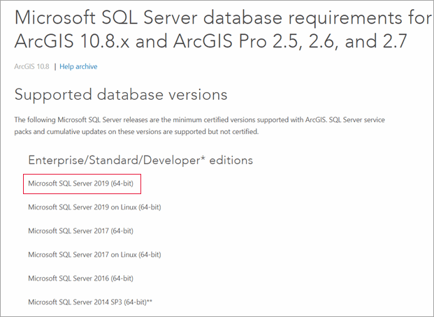

Lastly, they check the support of ArcMap with SQL Server 2022. After reviewing the Microsoft SQL Server database requirements for ArcMap, the GIS administrator determines that the most current version supported with ArcMap 10.8.1 is SQL Server 2019. Consequently, the desired DBMS version, SQL Server 2022, cannot be used. Additionally, since ArcMap 10.8.x is the last release and the product is scheduled to retire in 2026, the organization will upgrade to SQL Server 2019 until all third-party software integrations and customizations are migrated to ArcGIS Pro.
Note: See the following to check other DBMS version support with ArcMap:

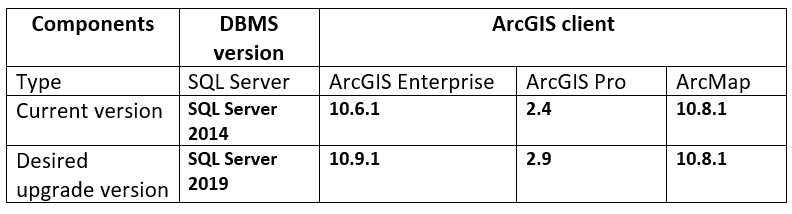

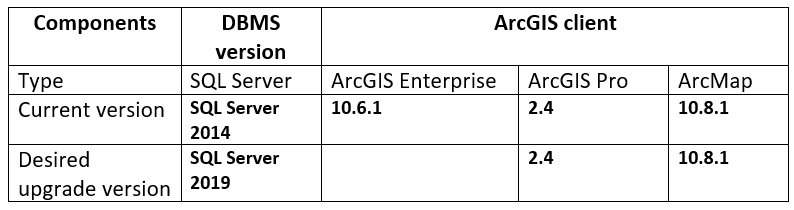

At this point, the GIS administrator has confirmed that the desired DBMS version for the organization’s upgrade is SQL Server 2019. After reevaluating the ArcGIS clients and DBMS versions, they confirm that all their current ArcGIS versions are supported with SQL Server 2019, except for ArcGIS Enterprise 10.6.1.
Updated assessment table
Next, they will decide on the most appropriate ArcGIS Enterprise version to upgrade to.

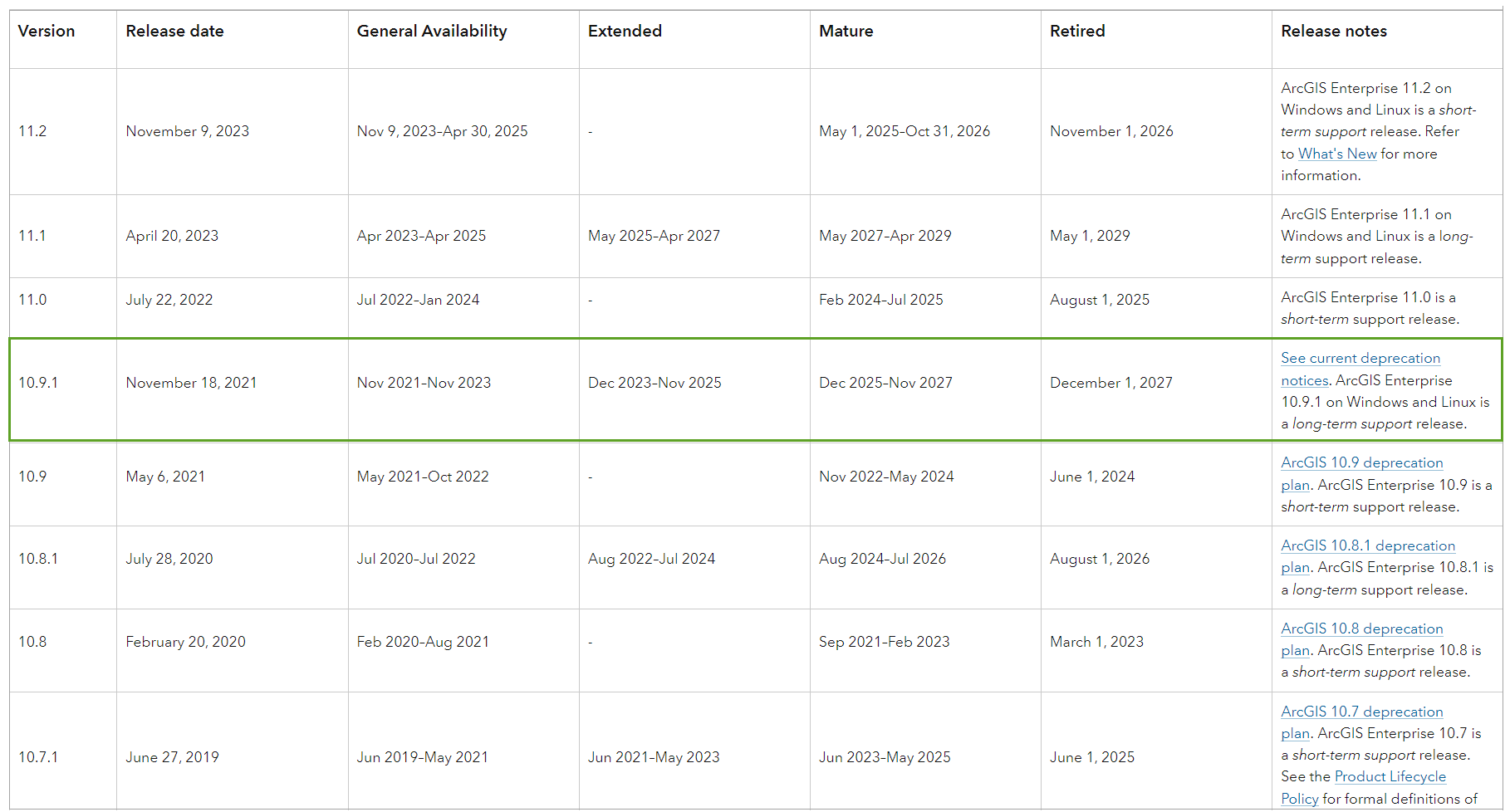

ArcGIS client lifecycle
After checking the ArcGIS Enterprise lifecycle documentation, the GIS administrator confirms the ArcGIS Enterprise 10.9.1 is a long-term support release, which means they can plan to upgrade on a less rigorous cadence than a short-term support release would require. Because of this, they make the final decision to upgrade to ArcGIS Enterprise 10.9.1.
ArcGIS Enterprise product lifecycle

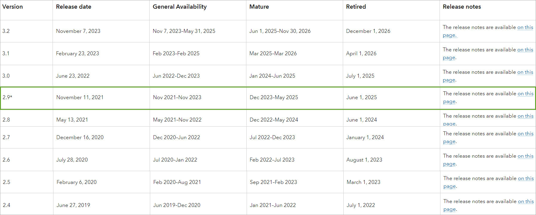

They next check the ArcGIS Pro lifecycle. Although the organization’s current version of ArcGIS Pro is supported with SQL Server 2019, the GIS administrator confirms that ArcGIS Pro 2.4 release already passed the retirement date. To ensure their department’s access to technical assistance to help troubleshoot issues, they will also upgrade ArcGIS Pro to version 2.9, which is the companion release of ArcGIS Enterprise 10.9.1.
ArcGIS Pro product lifecycle

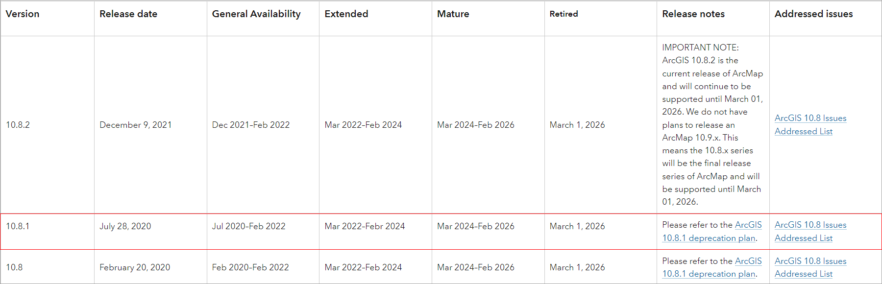

Lastly, from the ArcMap product lifecycle, they confirm that ArcMap 10.8.x is the current and final release of ArcMap, which will come out of support on March 1, 2026. This will give the organization some additional time to plan and migrate their current workflows to ArcGIS Pro.

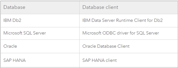

The database client software allows your ArcGIS client applications to communicate with the DBMS. When upgrading your DBMS version, it is essential to install a database client at a release that is compatible with the release of the database management system you are planning to upgrade to.
Install a compatible database client version on all ArcGIS client machines when connecting to the following:
DBMS clients
DBMS clients
You can obtain the database client installations from the database management system vendor. For IBM Data Server Runtime Client for Db2, the Windows version of the Microsoft ODBC driver for SQL Server, and the Oracle Instant Client, you can also download them from My Esri.
PostgreSQL client files are included in ArcGIS clients therefore, you do not need to install a PostgreSQL client separately. For ArcGIS Enterprise on Kubernetes, database client libraries are also included as a part of the container image definition, so no installation is necessary.
