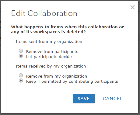

3. Configure what happens to shared and received data when you or other guests leave a collaboration.
New at 10.6, administrators can decide what happens to content shared and received once they delete or leave a collaboration or workspace. This saves the time it would take to unshare or delete individual items:Dialog box for collaboration's content deletion policy
Administrators can choose to remove their items, or let other collaboration participants decide. This delete content policy is configured at the collaboration level and applied to all related collaboration workspaces.
