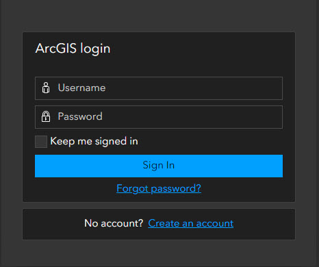

An example of the Built-In Login Window for ArcGIS Enterprise

  • Built-in identity store: This is the default authentication method in which user accounts are created directly within the ArcGIS Enterprise. It stores usernames, passwords, roles, and group memberships within ArcGIS Enterprise itself. This method is most commonly used for initial setup, development, and testing. The usernames and passwords are specific to each ArcGIS Enterprise deployment and won’t be found elsewhere.

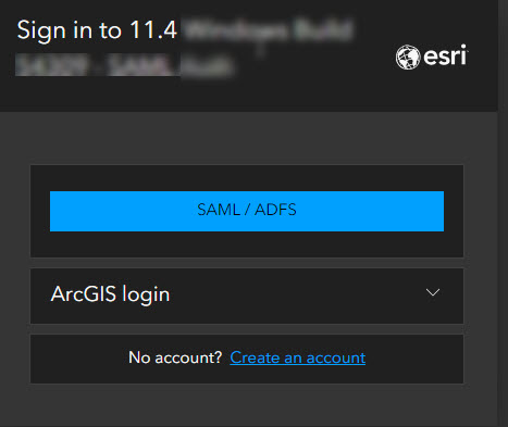

SAML Login Window
Example of SAML Login window in ArcGIS Enterprise
