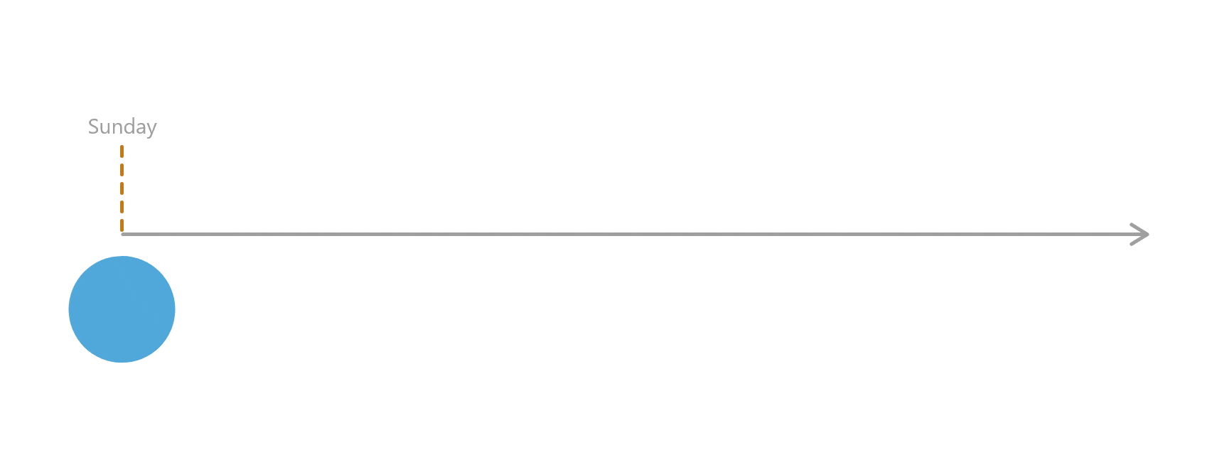

The webgisdr workflow is resource intensive for each of the machines participating in the ArcGIS Enterprise deployment, so it is important for administrators to time this process to execute during off-peak hours, ideally when no changes are being made to the organization. To alleviate these resource concerns, as well as to provide more frequent backups, webgisdr supports two running modes: ‘full’ and ‘incremental’.
Full backups take a complete snapshot of ArcGIS Enterprise and each of its components. It contains information on all the services published to ArcGIS Enterprise, hosted feature layer data, group and member information and much more. Full backups take more time and space to run but should be considered a full standalone export of the deployment.
Incremental backups are created based on an existing full backup to include updates that may have occurred between the two backups. The advantage of an incremental backup is that they generally take less time and resources to create than full backups and are smaller in file size. Even though they are more convenient, administrators should consider that they will essentially need to run two restore operations in the event of an incident, which may take more time depending on the length of time between the full backup and the incremental backup.
