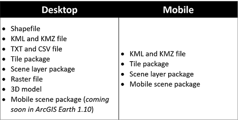

ArcGIS Earth supports a wide variety of local data formats that empower the disconnected 3D globe experience—scene layer packages, tile packages, raster/imagery, shapefiles, local elevation files, and more. The following are supported local data types:
![](https://www.esri.com/arcgis-blog/wp-content/uploads/2019/10/data-sources.png)
Users can also add KML/KMZ files, scene layer packages, tile packages, and raster data as local basemaps, and add raster data of the LERC tile format (Limited Error Raster Compression) as local terrain.

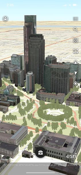

Mobile scene package
Mobile scene packages are designed to take your scenes and content offline for use across the ArcGIS Platform. They are already supported in the initial release of ArcGIS Earth for mobile and will be supported in the coming ArcGIS Earth 1.10 desktop release. Users can work with a disconnected globe in offline environments by preparing everything you need in a mobile scene package. Similarly, when creating mobile scene packages, you can add basemaps and terrain, specify usage limitations, add custom locators, and so forth, before you go offline.
ArcGIS Earth is designed to consume mobile scene packages. The user experience for consuming the mobile scene package differs slightly for desktop users and mobile users. With ArcGIS Earth for desktop, you can add one or multiple mobile scene packages as read-only scenes in the viewport, whereas with ArcGIS Earth on mobile, when adding a mobile scene package, it opens scene by scene and focuses the work on the current content on your mobile device.
![Add a mobile scene package in ArcGIS Earth on mobile Add a mobile scene package in ArcGIS Earth on mobile](https://www.esri.com/arcgis-blog/wp-content/uploads/2019/10/20191008143712.jpg)

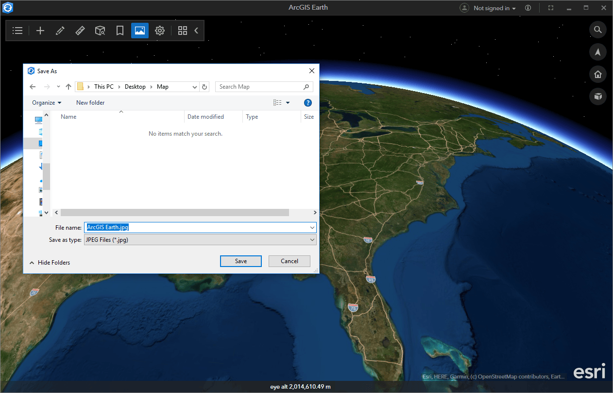

- Share a map by taking a snapshot of the current view and share it via email
- Save the sketch as a KMZ file locally
- Save KML edits as a new file (coming soon in ArcGIS Earth 1.10)
- Export and import the current workspace
![Take a snapshot of the current map Take a snapshot of the current map](https://www.esri.com/arcgis-blog/wp-content/uploads/2019/10/Save-as-Image.png)

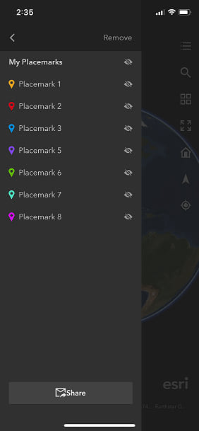

For mobile users, you can share collected placemarks as a KMZ file with one-click away and send it via email to your coworkers.
![Save placemarks as a KMZ file Save placemarks as a KMZ file](https://www.esri.com/arcgis-blog/wp-content/uploads/2019/10/20191008143825.png)
