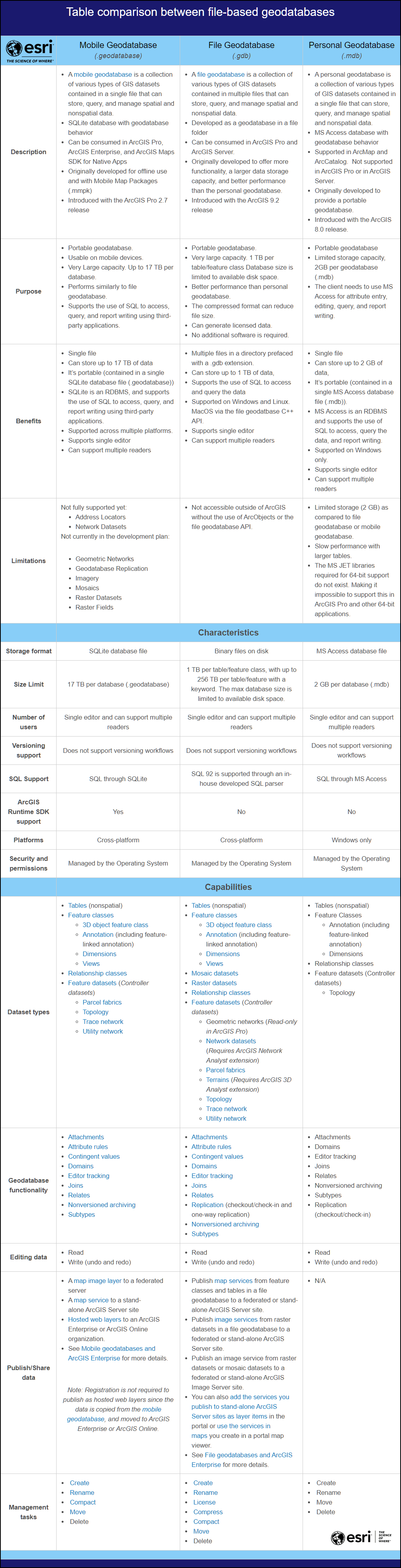

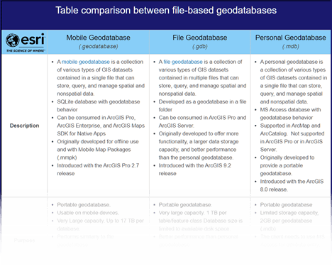

The following table compares the three “file-based” geodatabase storage types (i.e., mobile, file, and personal geodatabases) and excludes any information about Enterprise geodatabases.
Use one of the options below to view the content contained in this table comparison between file-based geodatabases:
- Table – All content within this table, including embedded links, is fully accessible.
Click this link to open a detailed table comparing file-based geodatabases.
Table comparison between file-based geodatabases |

- Image – A high-resolution image where the zoom tool can be used for better clarity. Please note that embedded links within this high-resolution image are not accessible.
Click this link or picture below to open a high-resolution image of the table.
Hopefully, having the information in this table comparison available at your fingertips will enable you to quickly find the details you need to make the best workflow decisions.

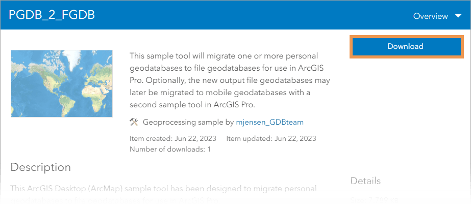

Step 1 – Download the tool.
- Click the following link, and when prompted, Sign in with your ArcGIS Online account to access the Migrate Personal Geodatabases to File Geodatabases (PGDB_2_FGDB) tool.
Note: If you are not a member of an ArcGIS Online organization, you can create a free public account with an ArcGIS login or create a public account with a social login to access ArcGIS Online. Once you’ve created an account, you can use it to sign in to ArcGIS Online. If you encounter any issues signing up, or signing into your account, see Account Troubleshoot.
- Click Download. This will download the
PGDB_2_FGDB.zip
file to your computer.

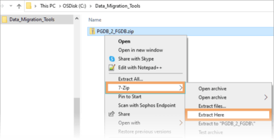

- Save the downloaded .zip file locally to your machine.
Example: On my local machine where ArcMap resides, I created a new folder named, Data_Migration_Tools.

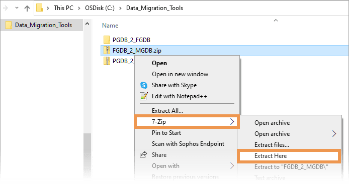

- Right-click the downloaded .zip file, click 7-Zip, then click Extract Here. The ArcMap toolbox, PGDB_2_FGDB.tbx, will appear in the folder.

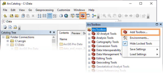

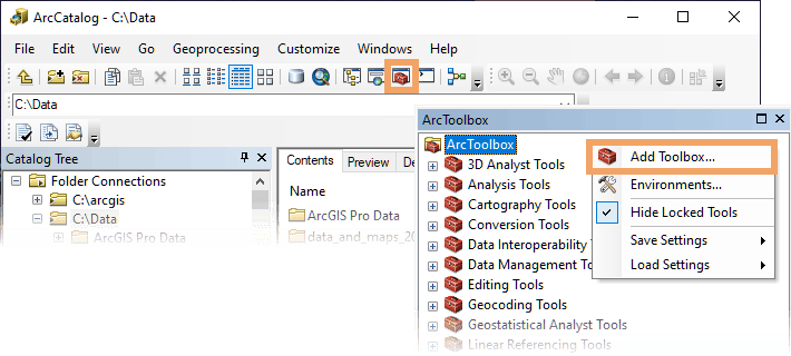

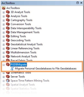

- To add a custom toolbox, open either ArcMap or ArcCatalog.
Note: This custom toolbox should be run in ArcGIS Desktop 10.x
- Click the ArcToolbox icon to open ArcToolbox.

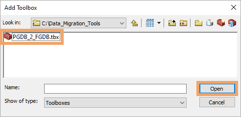

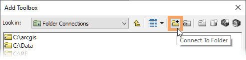

- From ArcToolbox, right-click in the white space and click Add Toolbox. The Add Toolbox dialog box opens.
- Browse to the location where you stored the PGDB_2_FGDB.tbx and select Open.

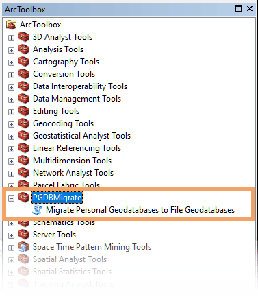

- This new toolbox, PGDBMigrate, appears in the ArcToolbox list; expand the toolbox to see the Migrate Personal Geodatabases to File Geodatabases tool.
- Double-click the Migrate Personal Geodatabases to File Geodatabases tool to open.

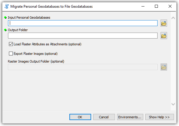

- Open the newly added Migrate Personal Geodatabases to the File Geodatabases tool from ArcCatalog or ArcMap.
Click here to access the Migrate Personal Geodatabases to File Geodatabases – Tool Parameters.
- Input Personal Geodatabases – The input geodatabases parameter can accept a single personal geodatabase or a folder with one or more personal geodatabases. The migration process will include personal geodatabases within sub-folders of the selected input folder.
- Output Folder – Select an output folder location to store the new file geodatabases.
Note: Sub-folder names with personal geodatabases will be created in the output folder containing the new file geodatabase. If a file geodatabase of the same name already exists, the tool will append a number to the end of the new file geodatabase name to maintain unique names.
- Load Raster Attributes as Attachments (optional) – By default, all feature classes with raster attributes will be loaded as attachments for each feature in the associated feature class.
- If unchecked, raster attributes will not be loaded as attachments into the new file geodatabase.
Note: Raster columns will not be migrated into file geodatabases as they are not supported in ArcGIS Pro.
- Export Raster Images (optional) – Check this box to export each raster attribute image to an output folder.
- Raster Images Output Folder (optional) – Output folder to store exported raster attribute images as .jpg files.
Note: Exported images will have the following naming format:

- Right-click the .zip file, click 7-Zip, then click Extract Here. The ArcMap toolbox, FGDB_2_MGDB.tbx, will appear in the folder.

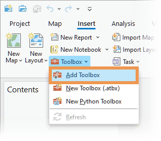

- To add a custom geoprocessing tool, open ArcGIS Pro.
- You can add a toolbox using one of the following options:
- From the Insert tab, click the drop-down next to Toolbox and click Add Toolbox.
- From the Catalog pane, right-click the Toolboxes folder, and click Add Toolbox.

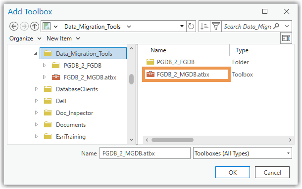

- Browse to the location where you stored the FGDB_2_MGDB.atbx and select Open.

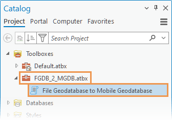

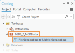

- From the Catalog pane, the newly added FGDB_2_MGDB toolbox is now under the Toolboxes folder. Expand the toolbox to see the File Geodatabase to Mobile Geodatabase tool.
- Double-click the File Geodatabase to Mobile Geodatabase tool to open.

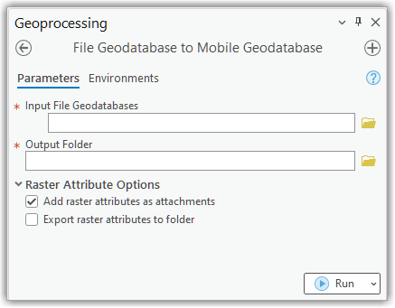

Migrate File Geodatabase to Mobile Geodatabase – Tool Parameters
- Input File Geodatabases – This parameter can accept a single file geodatabase or a folder that contains one or more file geodatabases, or a combination of both. Selected folders will automatically include file geodatabases within sub-folders for input and will be included in the migration process.
- Output Folder – Choose the output folder location to store the new mobile geodatabase(s). During the migration, starting with the root folder specified for this output folder location, this tool mimics the same folder and subfolder structure as the input file geodatabase parameter. The new mobile geodatabases maintain the same table, feature class, and folder structure names previously used in the file geodatabase. This also allows new mobile geodatabases of the same name to exist in different directory paths.
- Raster Attribute Options
- Add raster attributes as attachments – By default, if raster attributes exist in any feature class, they will be loaded as an attachment.
Note: Raster attributes are images that may be associated with each feature in a raster column of a feature class.
- If unchecked, raster attributes will not be loaded as attachments into the new mobile geodatabase. If no raster attributes exist, feature classes will not be enabled for attachments, and no attachments will be added.
Note: Raster attribute columns will not be migrated as they are not supported in mobile geodatabases.
- Export raster attributes to folder (Optional) – Check this option if you have raster attribute images that you would like to download to a selected folder.
- Raster Output Folder (Optional) – Choose the folder location to download raster attribute images as .jpg files.

I want to download our raster attribute images to an output folder but noticed that the naming of the image files could not be changed from GeodatabaseName_FeatureClassName_Raster_ObjectID.jpg. Are there any alternatives to being able to download images with a more descriptive file name?
Yes! A sample tool allows users to download attachments using field name values for renaming images from a feature class. This sample tool is referenced in this blog. This blog discusses how to create your own tool, but users can download a working version without writing code or making the tool themselves. Check out the blog and download your images after they have been attached with the Migrate Personal Geodatabases to File Geodatabases sample tool.
