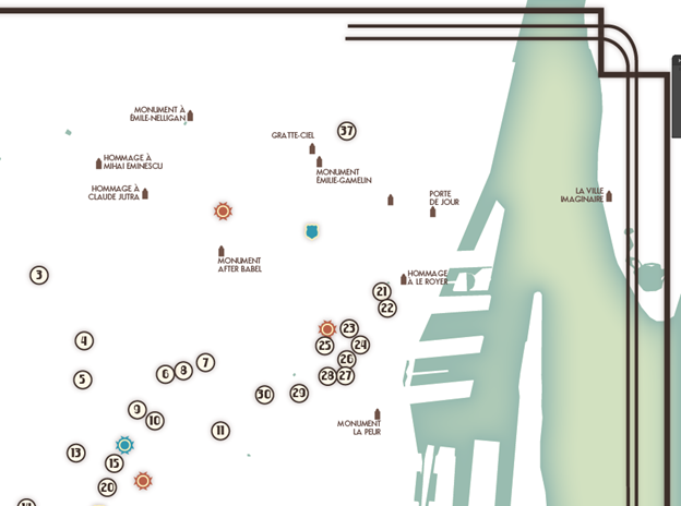

Some of the many custom symbols that were automatically placed using the M4CC extension in Adobe Illustrator

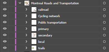

Roads and transportation data cateogorized by “type” field in the data. This is possible within the M4CC extension.
The M4CC extension gives you access ArcGIS Online smart-mapping tools, which provide a lot of geo-data visualization capabilities. This Montreal art deco map doesn’t have a lot of what can be considered data visualization, however all maps are a form of data visualization. I used the smart mapping tools to categorize the roads by type so that they would appear in separate categories as neatly organized sub-layers in the Illustrator Layers panel. This allows me to globally style each category accordingly. Categorization within the extension makes this possible.
