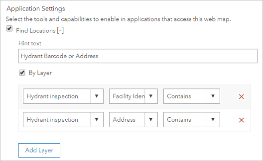

In this example, I have a hydrant inspection map for Collector and each hydrant has both a barcode (the facility identifier) and an address. To allow mobile workers to search by either of those values, I’ve updated the map to support search on both fields in my hydrant layer (in the Settings of the item page):
![Configuration to search multiple fields Configuration to search multiple fields](https://www.esri.com/arcgis-blog/wp-content/uploads/2019/08/multipleLayerSearch_Small.png)
As you can see in the image above, I also gave a hint text for the search so that mobile workers know what they can search for. In Collector (or Explorer), the mobile worker will see the search hint.

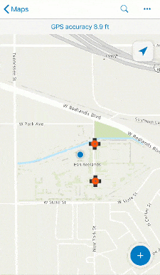

![Search hint text Search hint text](https://www.esri.com/arcgis-blog/wp-content/uploads/2019/08/multipleLayerSearchMobile_Small.png)
A mobile worker inspecting a hydrant scans the hydrant barcode in Collector to guarantee the correct hydrant is updated based on the inspection. If the mobile worker needs to visit the hydrant, they can type in the address. When doing a search (here for 15705), they’ll see results from both fields. In this example, there is a hydrant with that barcode, as well as one with that value in the address.
