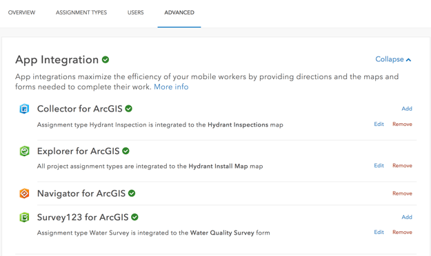

App integration within Workforce is achieved by creating a URL scheme for each point of integration and storing that scheme in the project JSON file. Here are the integrations for Survey123 and Collector.
![](https://www.esri.com/arcgis-blog/wp-content/uploads/2018/05/WorkforceIntegration.png)
Workforce handles this for you, but you can create and alter URL schemes yourself! In fact, you can modify the app integration in your Workforce project as well. We will save these details for a follow-on blog article.

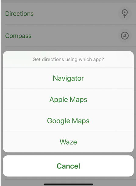

When dropping a pin on the map or from the popup details of a selected feature, you can ask Explorer for Directions. By default, Explorer will provide a menu of navigation apps that are installed on your device that can be remotely controlled. Within the settings you can alter that list to always launch your favorite navigation app as well.
