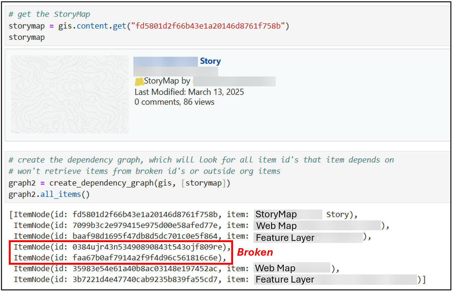

Let’s say that you are a GIS administrator who has been tasked with migrating your organization’s items to a different portal.  Perhaps it is from ArcGIS Enterprise to Online, or maybe from a development environment to a production environment.  Before migrating, you want to ensure that all of your items (including your complex apps) are rendering correctly and not missing any data sources, but you don’t want to manually click through to check each one.  How can you more efficiently find out what’s missing?
Here are the high-level steps:

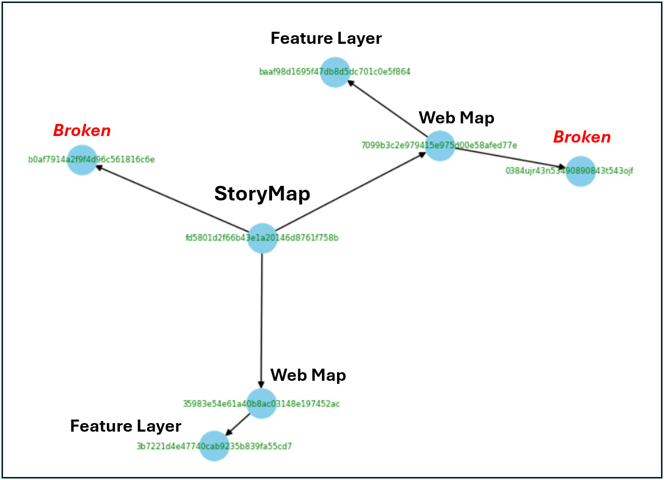

  • Create a dependency graph.
  • Identify the item ID’s that don’t correspond to existing or accessible items. Perhaps they no longer exist, are broken, or are not accessible to your organization.
  • Optionally visualize the dependency graph.
  • Replace the problematic item ID’s with the correct ID’s. This can be achieved using the remap_data method that was released in v2.4.0 of the Python API.
Example code for creating the dependency graph of a StoryMap.
Example visualization of the StoryMap’s dependency graph.

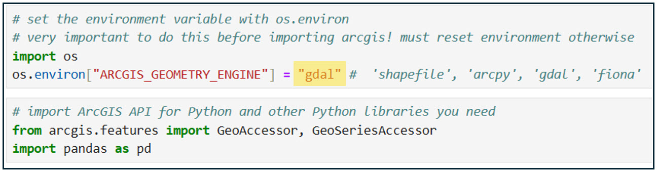

With the release of v2.4.1, we’ve incorporated GDAL into the reading/writing functions of the SeDF.  GDAL stands for Geospatial Data Abstraction Library, which is an open-source library that can read/write a wide variety of raster and vector geospatial data formats. It already comes in the standard environment for ArcGIS Pro on Windows and the ArcGIS Notebook Runtimes, and can also be installed via Python package managers Conda and Pip. This means that file geodatabases are now easily read into/written from the SeDF on Mac and Linux, and there is now a more consistent data I/O experience regardless of which OS you use the Python API with.
All you need to do is set the processing environment at the top of your script and point to your geometry engine of choice, then import arcgis and whatever other Python libraries you need to use!
