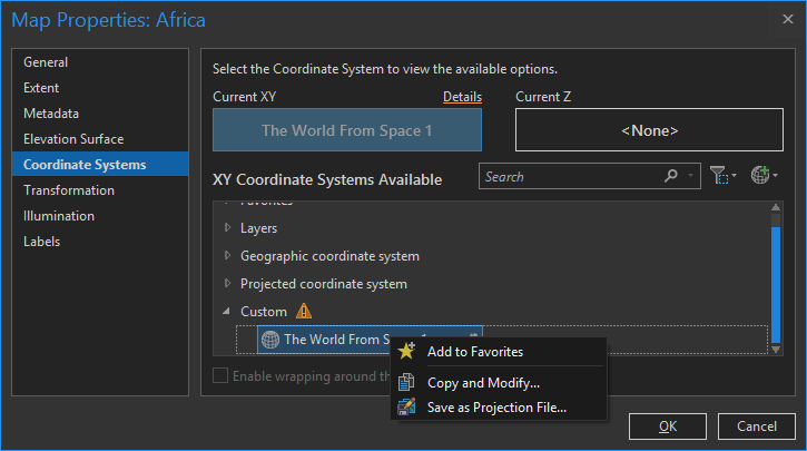

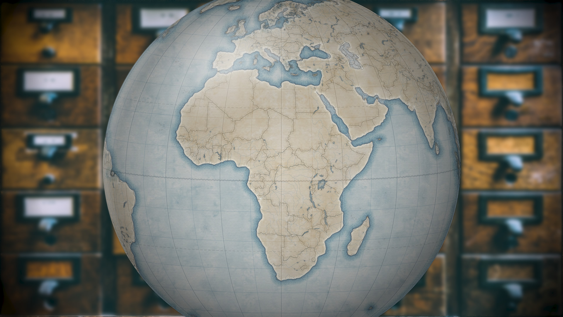

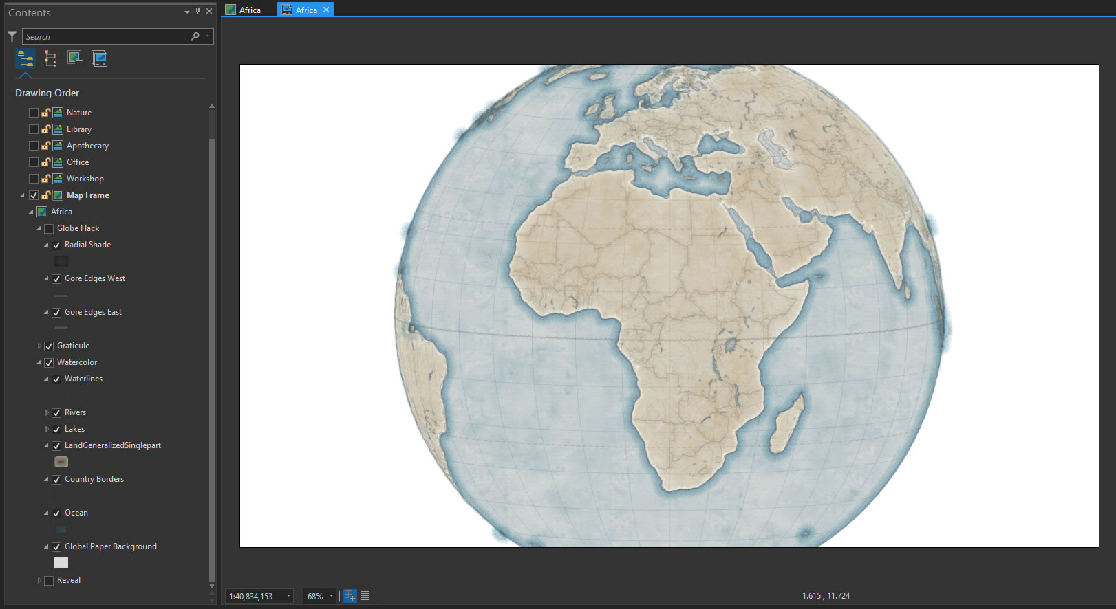

Projection. I used The World From Space projection, which is a pseudo-perspective projection that replicates what the world looks like from…oh, well, you get it. I modified the projection to be centered over the continent of Africa, for the purposes of the story map I’m working on. Or you could just use a 3D Scene.

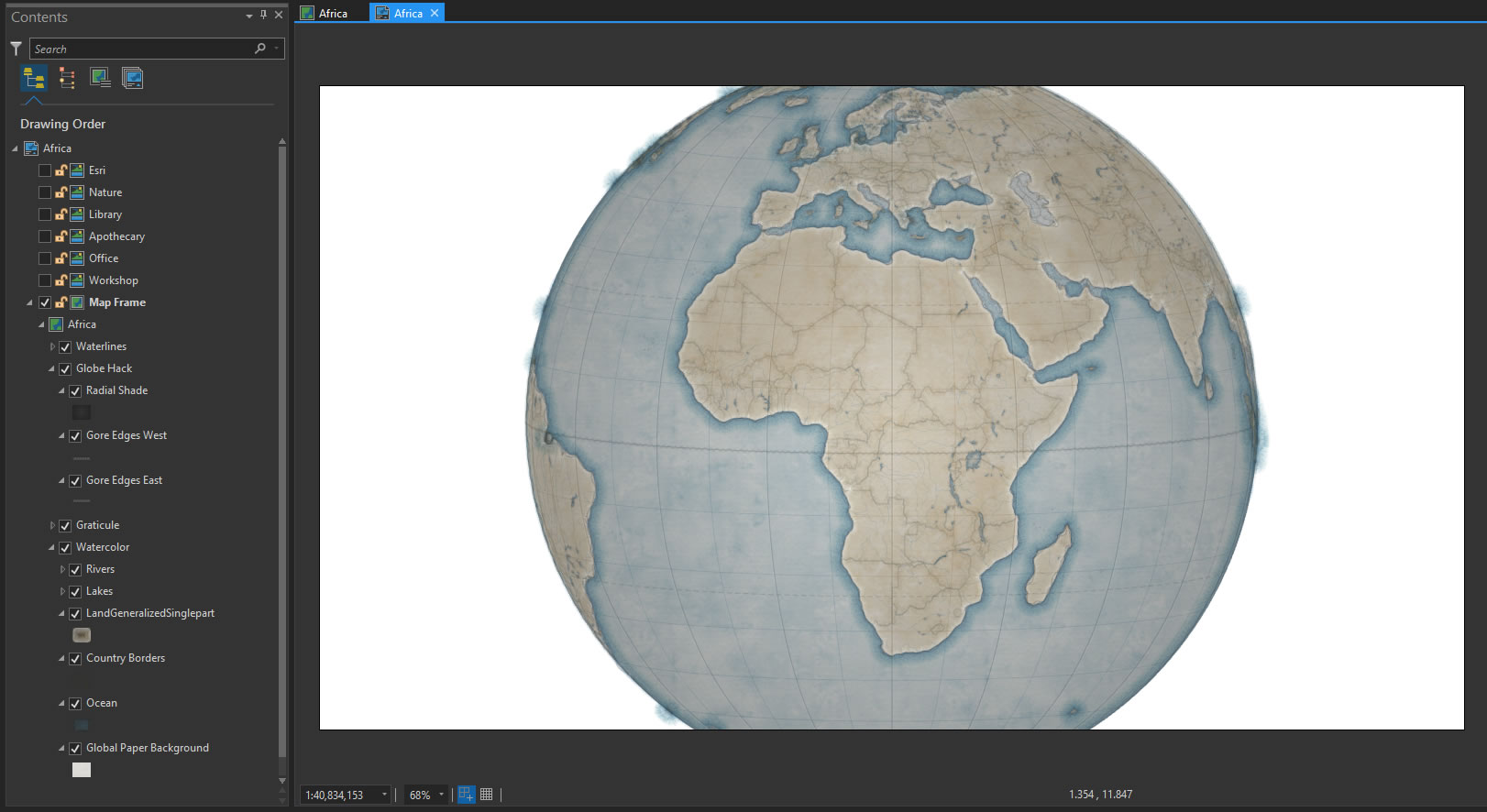

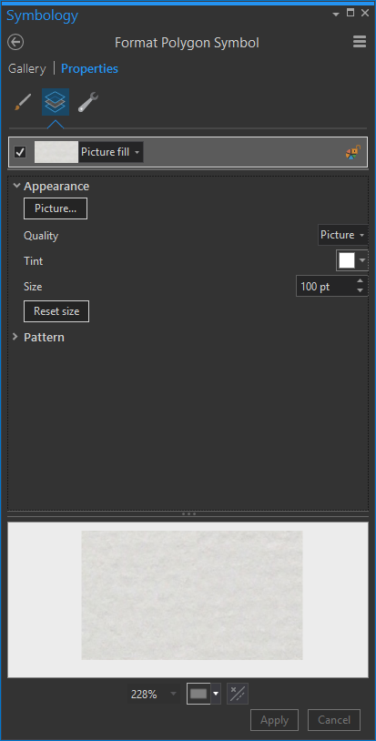

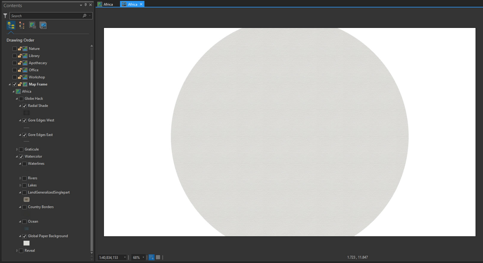

Surface. I draped the earth (I have an oft-used shapefile of a single polygon that covers the earth) in a watercolor paper texture. The polygon fill is a photo I snapped of my watercolor paper pad. Find all the assets, and the process, at this post about creating watercolor maps.

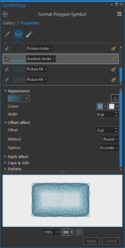

Watercolor. As I said, I took my inspiration from the Bellerby globe. I sampled their ocean and land colors and applied those tints to my trusty watercolor fill texture, available in the aforementioned post.
Graticule. Latitude and Longitude grid lines are a handy visual component for cartographers, for lots of reasons. Here is the map with those lovely parallels added in…
Looks pretty flat though. Neat, but not very convincing.

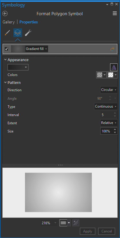

3D-ishness. There are two more layers that add to the fully-faked reality of this map-globe monster. I made a copy of my earth-covering polygon and gave it a radial fill of semi-transparent black at the edges.

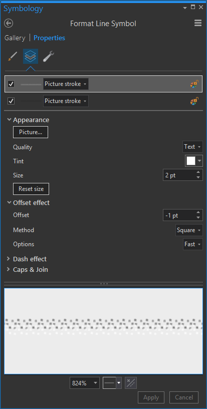

Ok, I’m particularly proud of this next stunt. Every globe, pretty much, is comprised of rounded triangles called gores that wrap up into a sphere. Try as they might, globe makers can never fully erase these seems if you look closely enough. But I like that. It belies something hand-made and wonderful. So I used a definition query to reduce a layer of longitude lines to only every 20 degrees. Then I gave the line a dual stroke. One side is faint white and one side is faint black. I did this for western hemisphere lines and reversed it for eastern hemisphere lines. Together they conspire to replicate the thin paper fault line and lip at the border of the gores.
All together they help sell the roundines/paperiness…

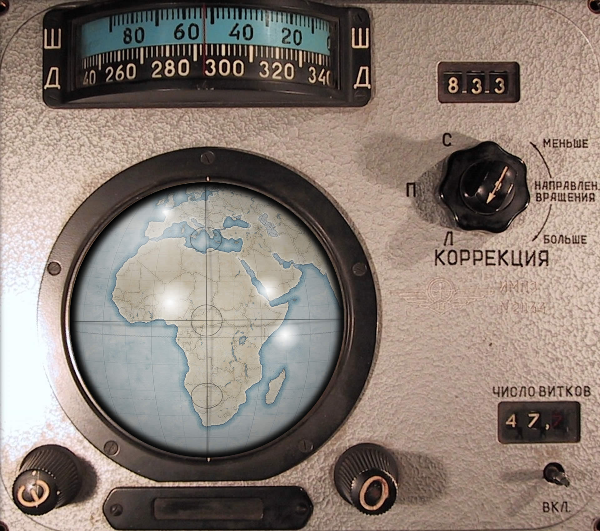

Try on for size this soviet-era Globus IMP Voskhod spacecraft navigation instrument, for instance…
