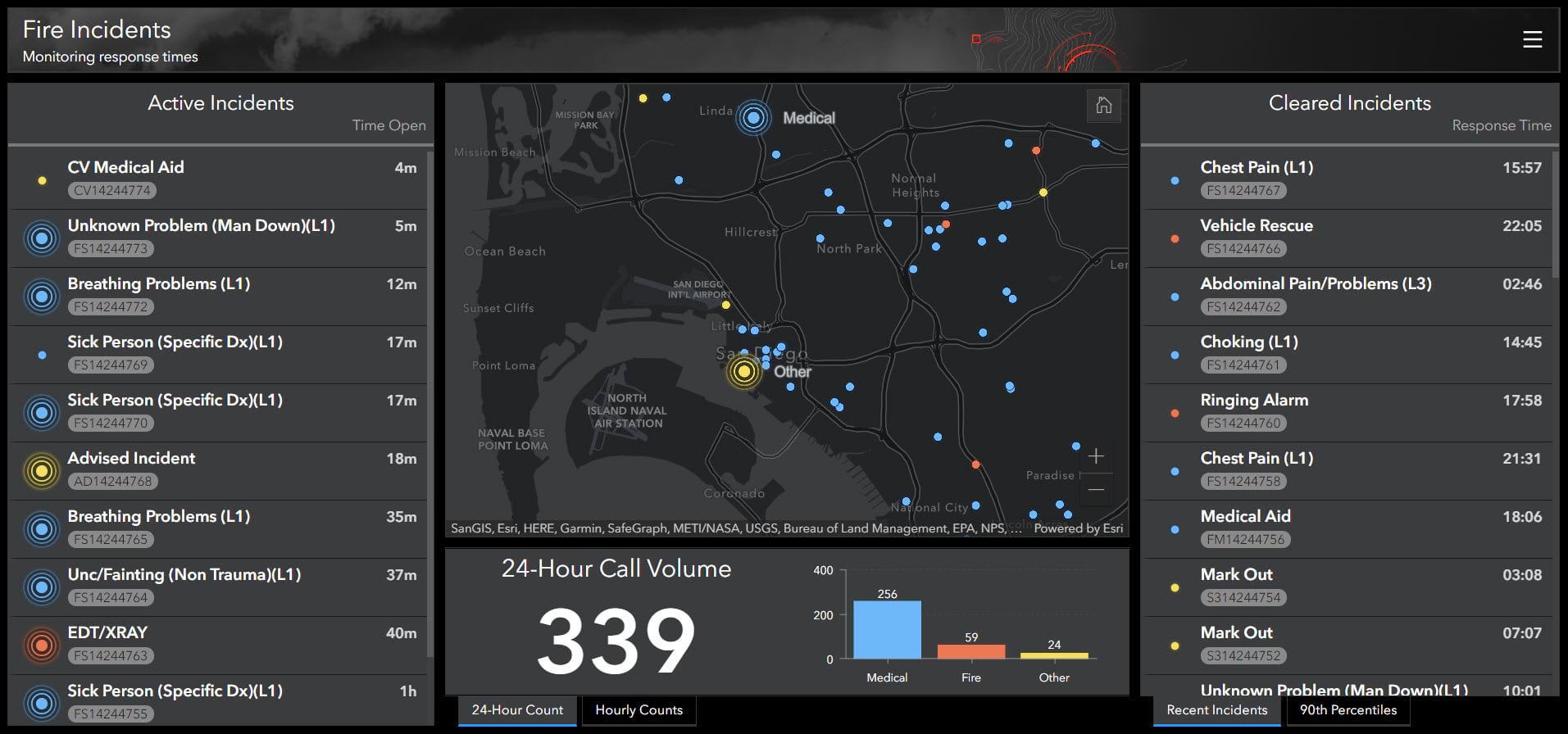

Fire incidents dashboard
This dashboard is being used to monitor emergency calls as they come in and their status (active and cleared). The list on the left shows open incidents and the time that has elapsed since they were opened while the list on the right shows cleared incidents and how long each one took to clear (the response time).
This elapsed time information is not a field in the dataset but rather a calculation in an Arcade expression with a little bit of formatting. Here’s how it was done.
