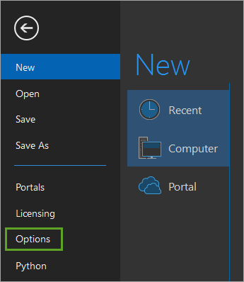

3. On the ribbon, on the Project tab, then click Options.
Update project options

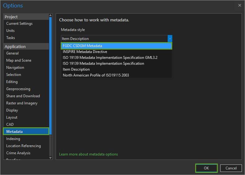

4. In the Options pane for Project options, choose Metadata.
ArcGIS Pro is set to use the Item Description metadata style by default, other metadata styles are available that provide access to more of an item’s metadata content. Next, you will change the metadata style to the Federal Geographic Data Committee‘s (FGDC) Content Standard for Digital Spatial Metadata (CSDGM) which is a well-known metadata content standard that has been used in North America and around the world for many years.
5. From the Metadata style drop-down menu, choose FGDC CSDGM Metadata and click OK.
Choose metadata style

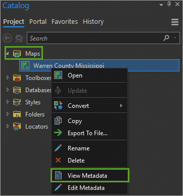

7. In the Catalog pane, expand Maps.
8. In the list of maps, right-click Warren County Mississippi, and choose View Metadata.
Display Map metadata

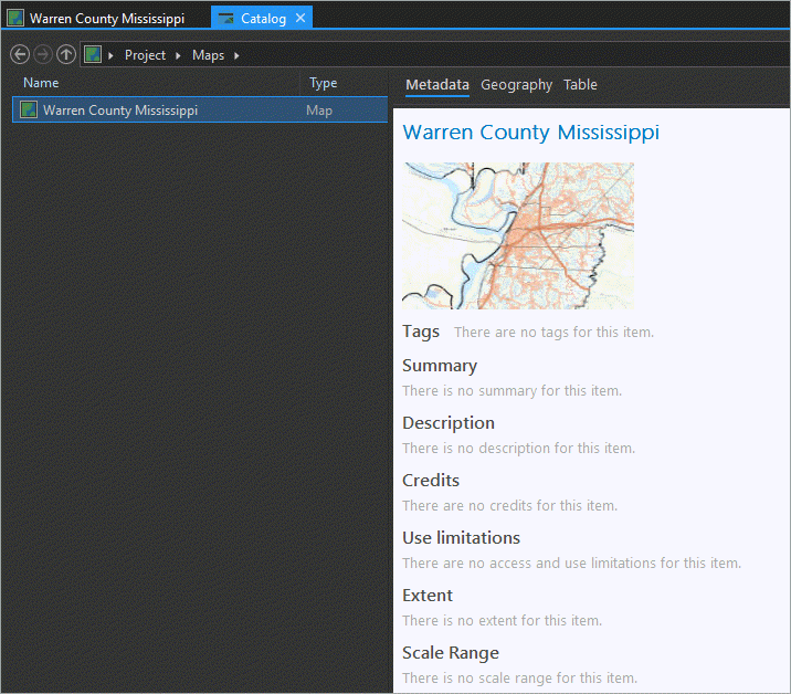

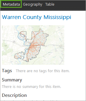

You will use the Catalog View while updating metadata. The Catalog View displays a details panel with the current metadata for the map.
Your map has no metadata defined, it would be useful if it had a summary of the data layers and a description of the symbology and coordinate system used for the map.
Warren County map metadata

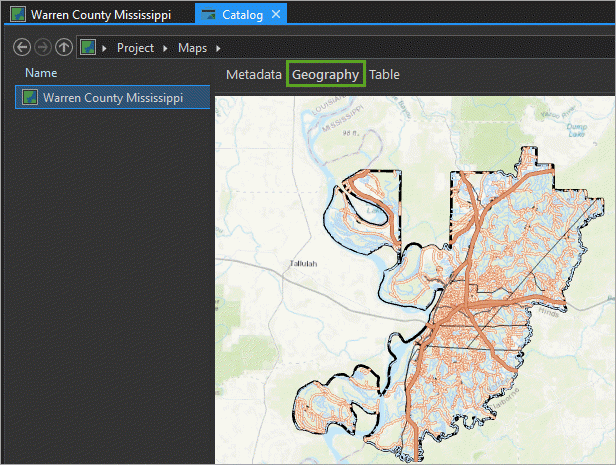

11. In the Catalog view, click Geography.
Show geography on Details pane
12. On the ribbon click the Preview tab in the Navigate group, use the Pan and Zoom tools to update the display extent to Warren County.
13. In the Preview group, click Create Thumbnail.

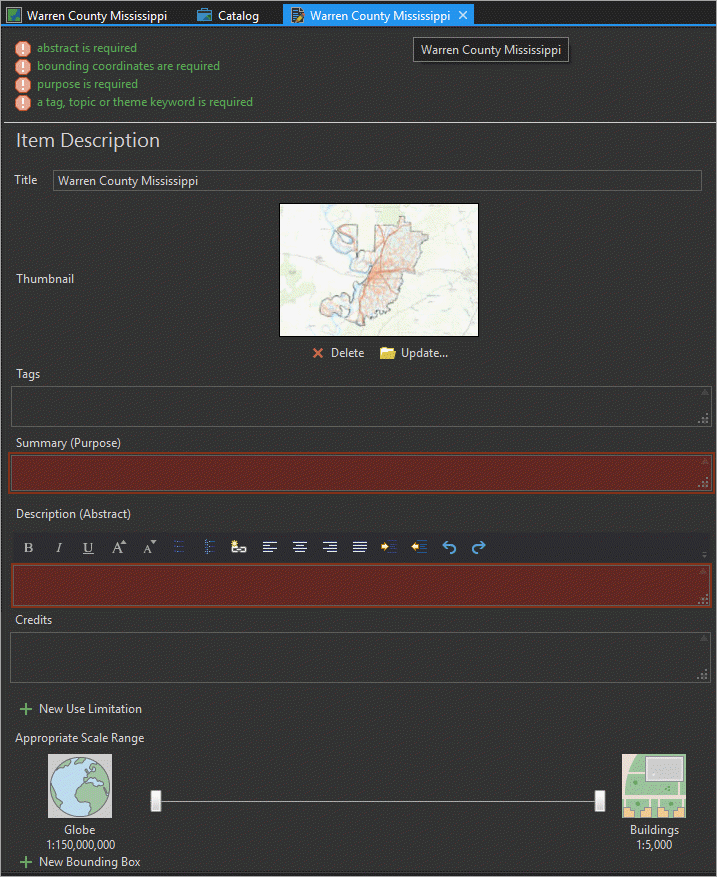

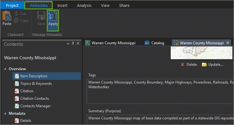

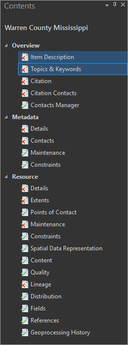

16. Review the Contents pane  and note that it displays available metadata categories  that may be updated; these include an overview, metadata and resources page.
Contents pane metadata pages

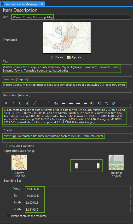

17. In the Metadata editor pane, add the following information:
  • For Title, type – Warren County Mississippi Map
  • For Tags, type – Warren County Mississippi, County Boundary, Major Highways, Powerlines, Railroads, Roads, Streams, Towns, Township boundaries, Waterbodies
  • For Summary (Purpose), type – Warren County Mississippi map of base data compiled as part of a statewide GIS repository effort.
  • For Description (Abstract), type – A map containing vector data set layers of base data for Warren County Mississippi. Created using 1990 US Census Bureau TIGER files and periodically updated. The data for county-wide files have been clipped using 1:100,000 county borders from USGS Census TIGER files. In 2012, MARIS staff updated linework using 2006 MDEM 2 foot imagery, 2010 1 meter USDA NAIP Imagery, MS DOT’s 2009 Official road Map of Mississippi, and 1 foot BING Pictometry imagery.
  • For Credits, type – Mississippi Automated Resource Information System (MARIS) Technical Center
  • Set the minimum Appropriate Scale Range  to 1:500,000 and the maximum to 1:5,000
  • For Bounding Box, click New Bounding Box and type the following coordinates.
    West -91.175758 East -90.550942
    South 32.079123 North  32.619685
Updated map metadata

18. On the ribbon, on the Metadata tab, in the Manage Metadata group, click Apply and click Save.
Apply metadata updates and save

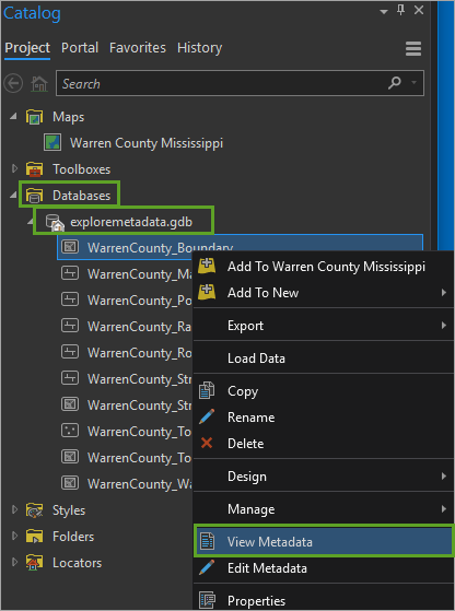

2. In the Catalog pane, expand Databases, and expand exploremetadata.gdb
3. Right-click the WarrenCounty_Boundary feature class and select View Metadata.
Display feature class metadata
The Catalog view updates to display the current metadata for the feature class.

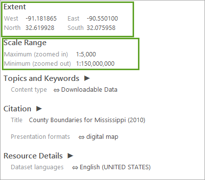

6. Scroll down the Details pane until you reach the Extent and Scale Range values.
These values have also been set correctly.
Metadata extent and scale

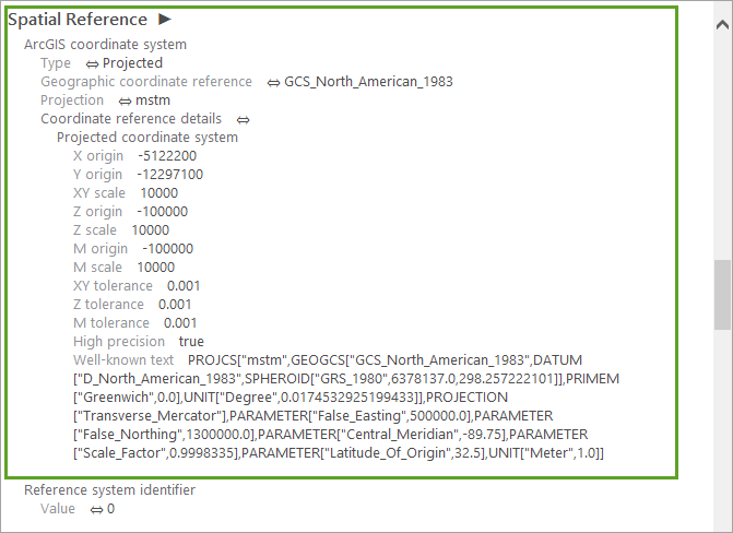

7. Scroll down the Details pane until you reach the Spatial Reference section.
The projection is defined as mstm. This is state of Mississippi specific spatial reference system developed to store geographic data for entire state in a single projected system.
It has the following properties:

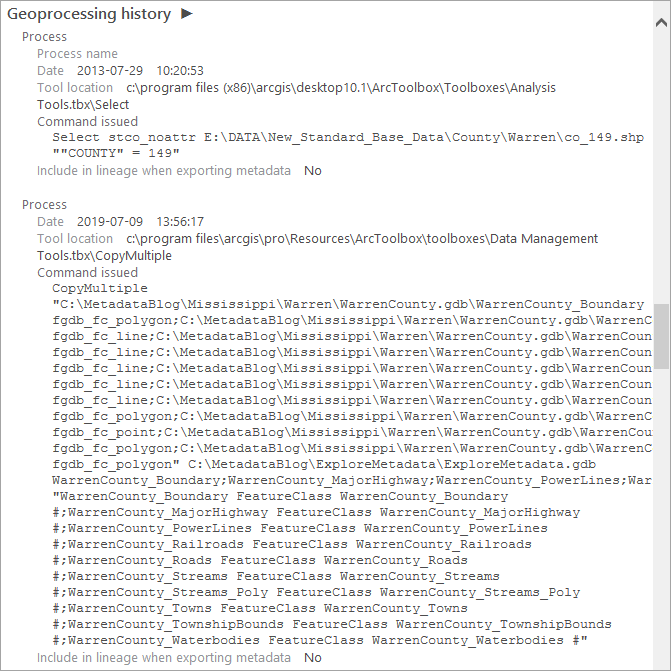

8. Scroll down until you reach the  Geoprocessing history section.
This data source represents a selection made from an original shapefile containing all counties in the state of Mississippi.
The fact that the data was originally sourced from a shapefile is a good indicator of possible limitations.  Shapefiles do not contain an x,y tolerance like geodatabase feature classes and dont support circular arc curves that use a mathematical formula to draw the curve.

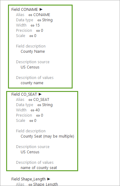

9. Scroll down until you reach the Field section.
Again the fact that the source for this data was a shapefile is a good indicator of potential attribute limitations.
For shapefiles the following limitations apply:
  • Field names cannot be longer than 10 characters.
  • The maximum record length for an attribute is 4,000 bytes
  • They do not support type BLOB, GUID, global ID, coordinate ID, or raster field types.
  • Null values are not supported.
  • Date fields only support date an do not support time.
Thus by reviewing the field descriptions and field types you can determine if this data source is constrained by the original shapefile properties.
