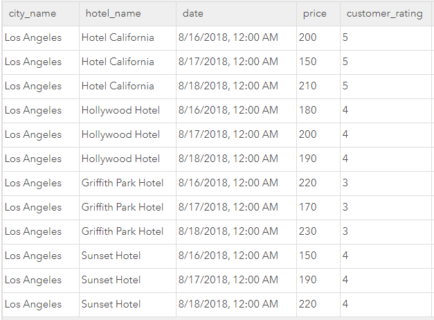

I mentioned previously that having is used with groupByForStatistics, outStatistics, and sometimes the where clause, geometry and time parameters, but I didn’t tell you how they might be used together. Let’s set up a scenario to help explain. You’re looking for a hotel in Los Angeles between August 16th and August 18th and you have data that contains information about the date, price per night, and the overall customer rating. You published your data as a feature service and you want to do some queries using the having clause to narrow down your choices (whoa, what a coincidence!). Suppose you want to find a hotel where the average price per nice is less than $200, but you only want hotels with a minimum customer rating greater than or equal to 4/5 using the subset of data below.

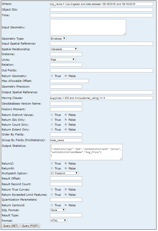

Now let’s see this in the layer query resource:
Note: This layout may be different depending on what feature service you’re working with.
The query returned three results:
