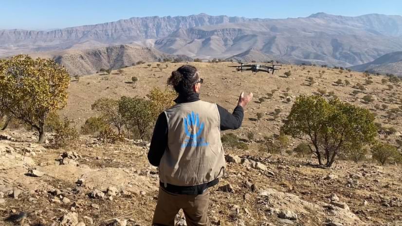

John Fardoulis of Mobility Robotics conducts a drone flight for demining work in Iraq. (Photo courtesy of John Fardoulis)

In support of the Odyssey 2025 project, John Fardoulis, director of Mobility Robotics, takes a science-based approach using drones and GIS. He has been to almost 300 minefields since 2018, testing high-tech and low-cost solutions that can be customized based on local minefield conditions.

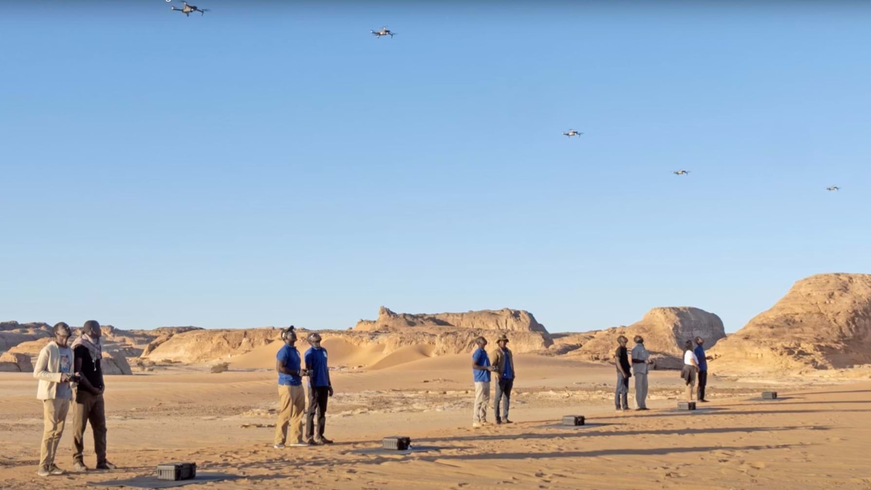

In Chad, the Odyssey 2025 demining team learned many lessons, including how to deal with Saharan heat. The team combed the desert from 2018 to 2021 to help undo the ongoing harms of landmines placed during Chad’s civil war 30 years ago. The aim was to return the land to the people, eliminating the horror of children and livestock wandering into minefields to be maimed or killed.

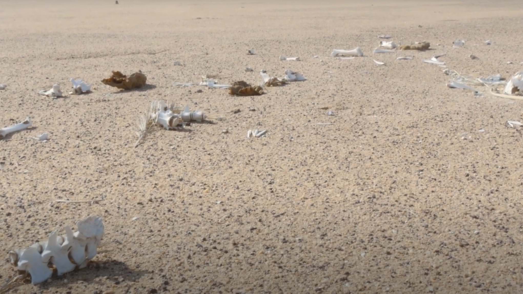

Desert landscapes pose a particular challenge to deminers. Shifting sands erase telltale tracks. The featureless surroundings and lack of landmarks are dangerously disorienting. Mines could be anywhere. One morning, as the team neared a known minefield, the road disappeared into a sand dune. Short forays ahead failed to find the path.
Then, Fardoulis sent up a drone. From above, stones at the road’s edge popped out and he mapped them. “We joined the dots,” he said. “It saved months of work on the ground trying to find the starting point.”

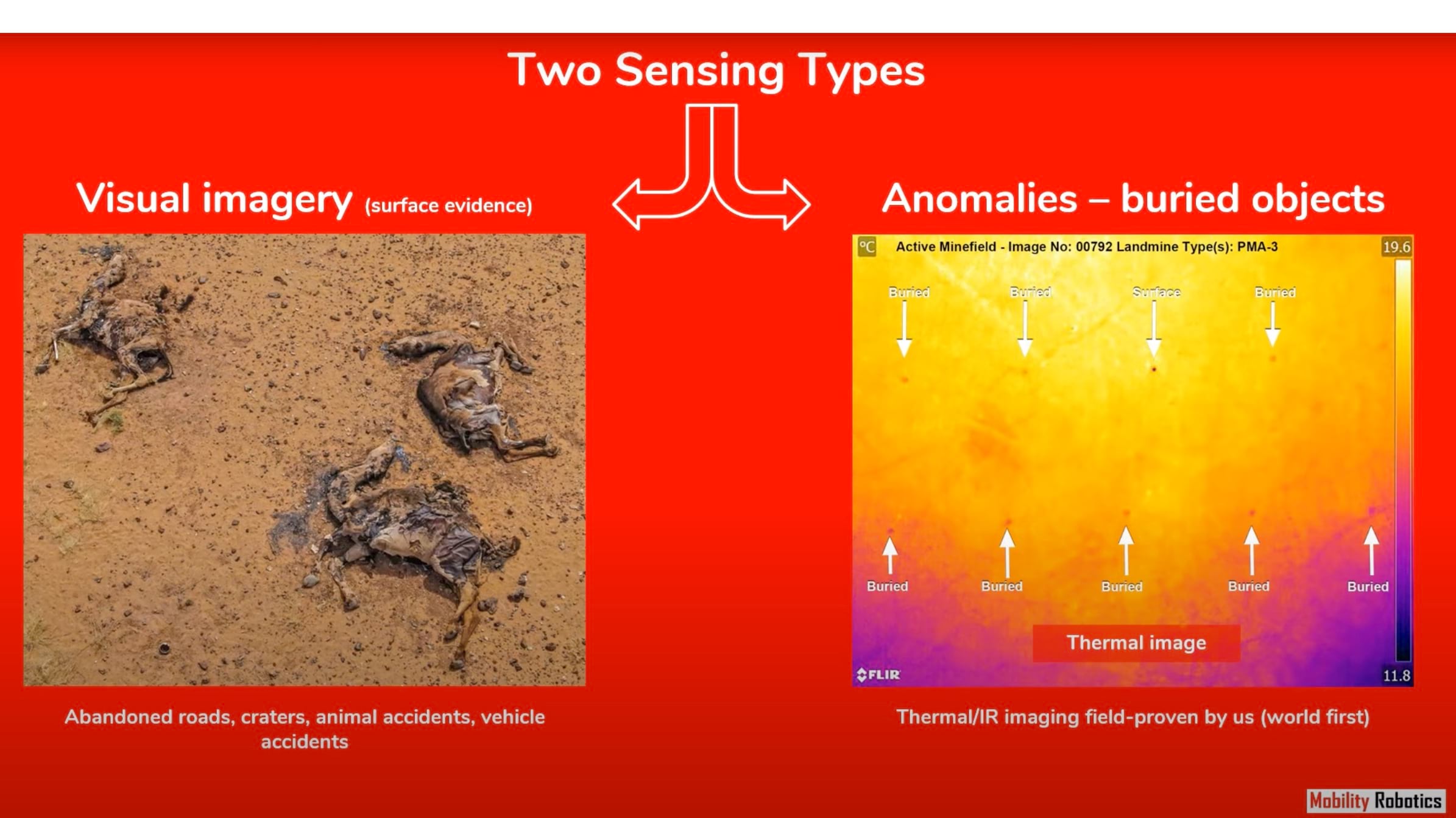

In Chad, Fardoulis prototyped thermal/long wave infrared imaging, also known as thermography, to find the location of landmines. First, the team established a test site to monitor the thermal properties of buried mines at different times of day. They found the best time to fly was from 4 a.m. to sunrise in the summer, which also meant they could escape the daytime heat that exceeded 120 degrees Fahrenheit.
This thermal imaging method exploits the different heat retention properties of mines, compared to the surrounding sand. Plastic mines create a cool patch during the day and a hot patch at night, while metal mines do the opposite.
With this technology, the team detected more than 2,500 buried landmines in Chad— discerning the location and type—and marked a significant advancement in the field of humanitarian demining.

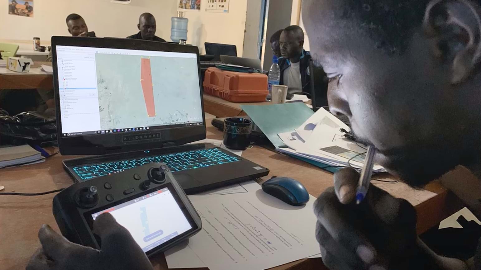

Minefield maps, made with ArcGIS, inform the planning and evaluation phases.
“Say we take 3,000 photos, like I did today of a 400,000-square-meter area,” Fardoulis said. “GIS allows us to plot and analyze each photo and to draw evidence points as pins on the map.”
Deminers take the map into the field using a GIS app on phones or tablets. They cross-check mine locations identified by drone imagery with manual, mechanical, or animal detection systems before carefully taking out each mine. They capture their work on the map to share where they have been and record which areas still need to be cleared.

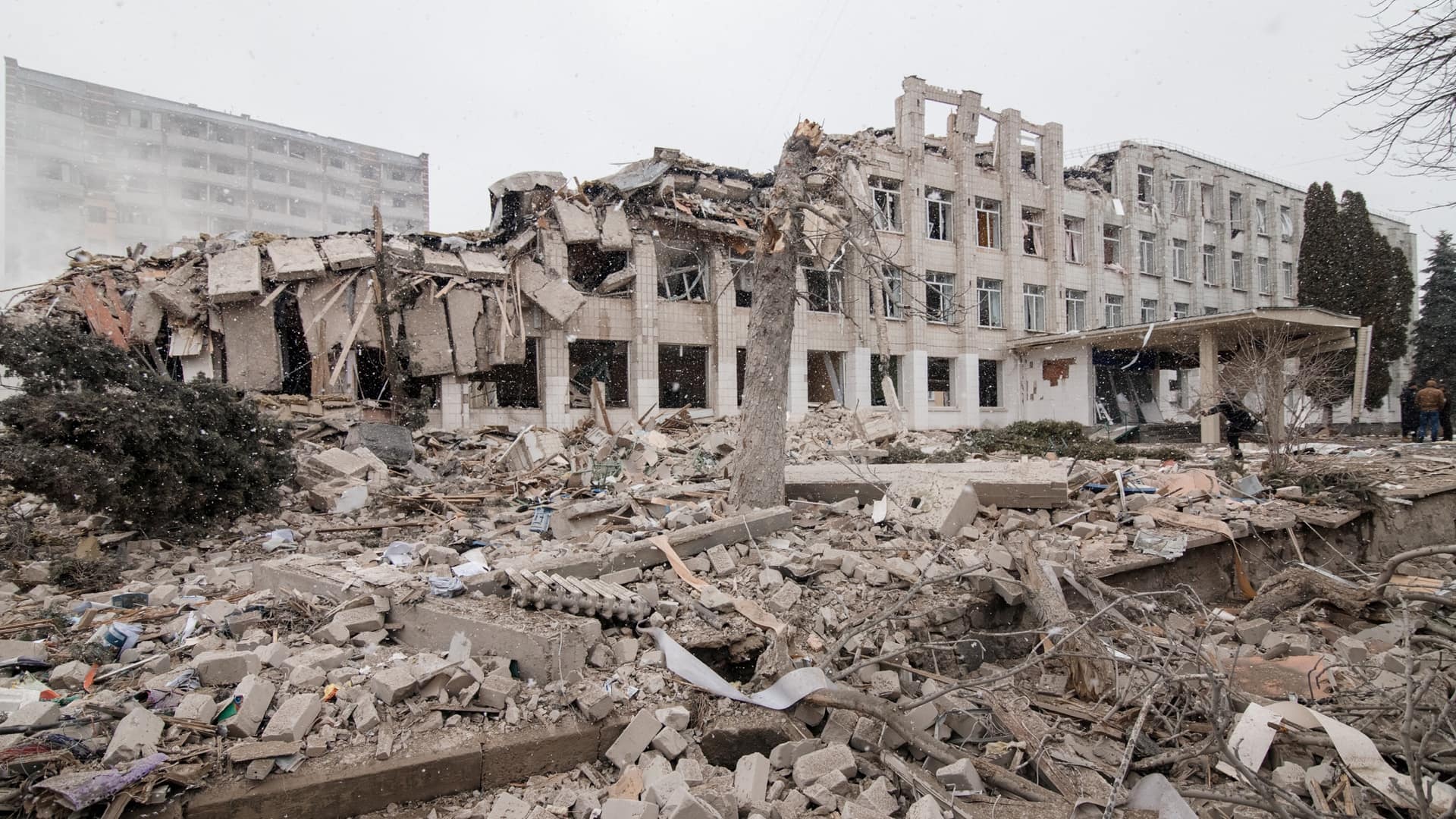

The lessons learned by teams from Humanity & Inclusion and Mobility Robotics over the past five years are now being applied in Ukraine—where there is the world’s largest concentration of minefields.
The new thermal method effective in the sands of Chad doesn’t work in Ukraine’s denser soils. Instead, Fardoulis and team have been perfecting high-resolution mapping with outputs called orthomosaics to visually inspect fields. Because the conflict is so fresh, this high-resolution imagery can show unexploded bombs sitting on the surface or reveal disturbances in the dirt that signal potential buried mines.
