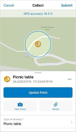

Step 4: Walk to a picnic table at the park. Tap Add and select the picnic table icon
to capture its location.

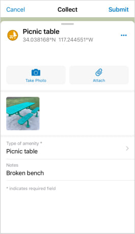

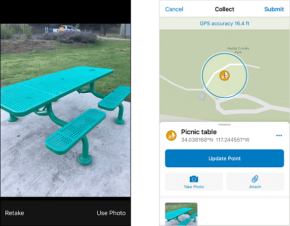

Step 5: Tap Take Photo and take a picture of the picnic table. Tap Use Photo to attach the picture. After you submit your picnic table in step 7, the picture will be available for anyone reviewing the captured data.
Step 6: You notice the picnic table has a broken bench. Scroll the form and add a note about the broken bench
Step 7: Tap Submit to share the picnic table information you collected with everyone who has access to the layer.

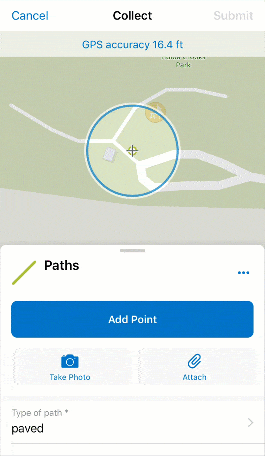

Step 8: Next, you will collect data about a path. Walk to the start of the sidewalk near the picnic table and tap Add (as you did in step 4). This time, select a paved path.
Step 9: You want to capture the path as you walk along it, so you’ll stream the data by tapping Overflow and then tapping Start Streaming. Walk along the path, and it is drawn as you go.
Step 10: Once you’ve finished walking the path, tap Stop Streaming. Optionally, add a photo and a note, as you did for the picnic table, and tap Submit to add the path to the layer.
