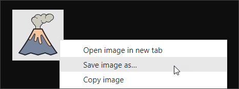

Right-click to save the image to your local drive. The options you see will depend on your browser. Shown below are the options when using Google Chrome.

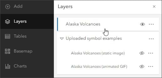

Step 3: In the sample map, open the Layers pane from the Contents (dark) toolbar. Ensure that the Alaska Volcanoes layer is selected and the Uploaded symbol examples layer is hidden.

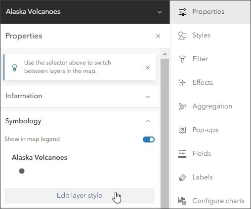

Step 4: In the Settings (light) toolbar, open the Properties pane and click Edit layer style.
![](https://www.esri.com/about/newsroom/wp-content/uploads/2023/04/april-tip5.jpg)

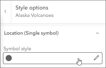

Step 6: Click to edit the current symbol style.

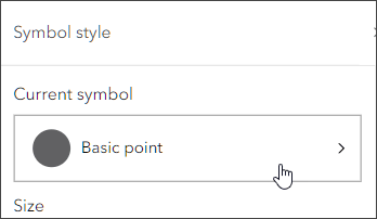

Step 7: The current symbol is Basic point. Click to change it.
![](https://www.esri.com/about/newsroom/wp-content/uploads/2023/04/april-tip8.png)

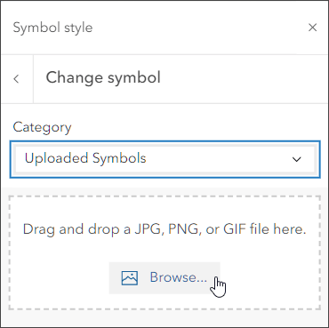

Step 9: Click Browse to navigate to the volcano image on your local drive and select it to use it as your point style. Alternately, you can add the image by dragging it into the dotted field.
![](https://www.esri.com/about/newsroom/wp-content/uploads/2023/04/april-tip10.png)

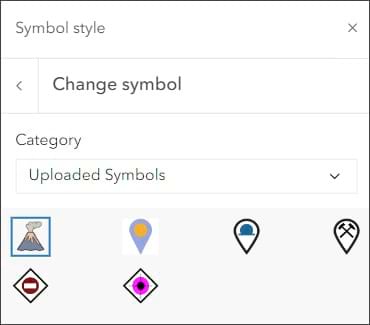

Note: Uploaded symbols will remain until you clear your browser’s cache, so you can go back and reuse them. Uploaded symbols cannot currently be saved for other members of your organization to use, so members must add them individually from local files.
![](https://www.esri.com/about/newsroom/wp-content/uploads/2023/04/april-tip11.jpg)
Now each point symbolizing the location of volcanoes on the peninsula has been replaced by the uploaded image, adding a dynamic twist to the information provided on the map. Once added, uploaded symbols can be resized and rotated and have effects applied like any other symbol.

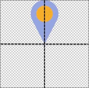

When creating your own symbol, note that the center of the image is placed on the x,y coordinates point location. For example, the symbol below will be placed with its center (where the dashed lines cross) on the x,y coordinates location of the point on the map.
![](https://www.esri.com/about/newsroom/wp-content/uploads/2023/04/april-tip12.jpg)

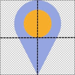

To place the bottom tip of the symbol on the x,y coordinates location, create a symbol as shown below, placing the tip of the “tail” at the center of the image.
![](https://www.esri.com/about/newsroom/wp-content/uploads/2023/04/april-tip13.jpg)
