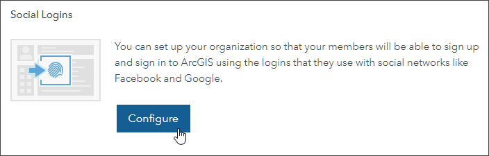

As an administrator, go to Settings and click on the Security tab. Locate the Social Logins section and click Configure.
![](https://www.esri.com/about/newsroom/wp-content/uploads/2019/02/sociallogins1.png)

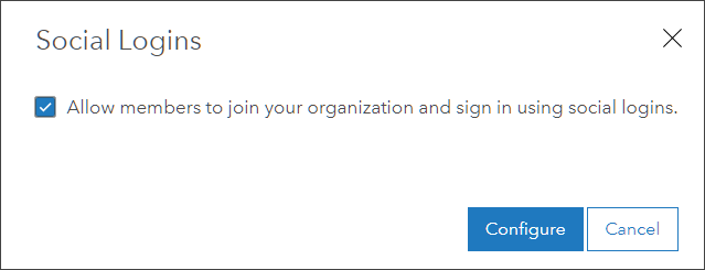

Check the Allow members to join your organization and sign in using social logins box. Click Configure.
![](https://www.esri.com/about/newsroom/wp-content/uploads/2019/02/sociallogins2.png)

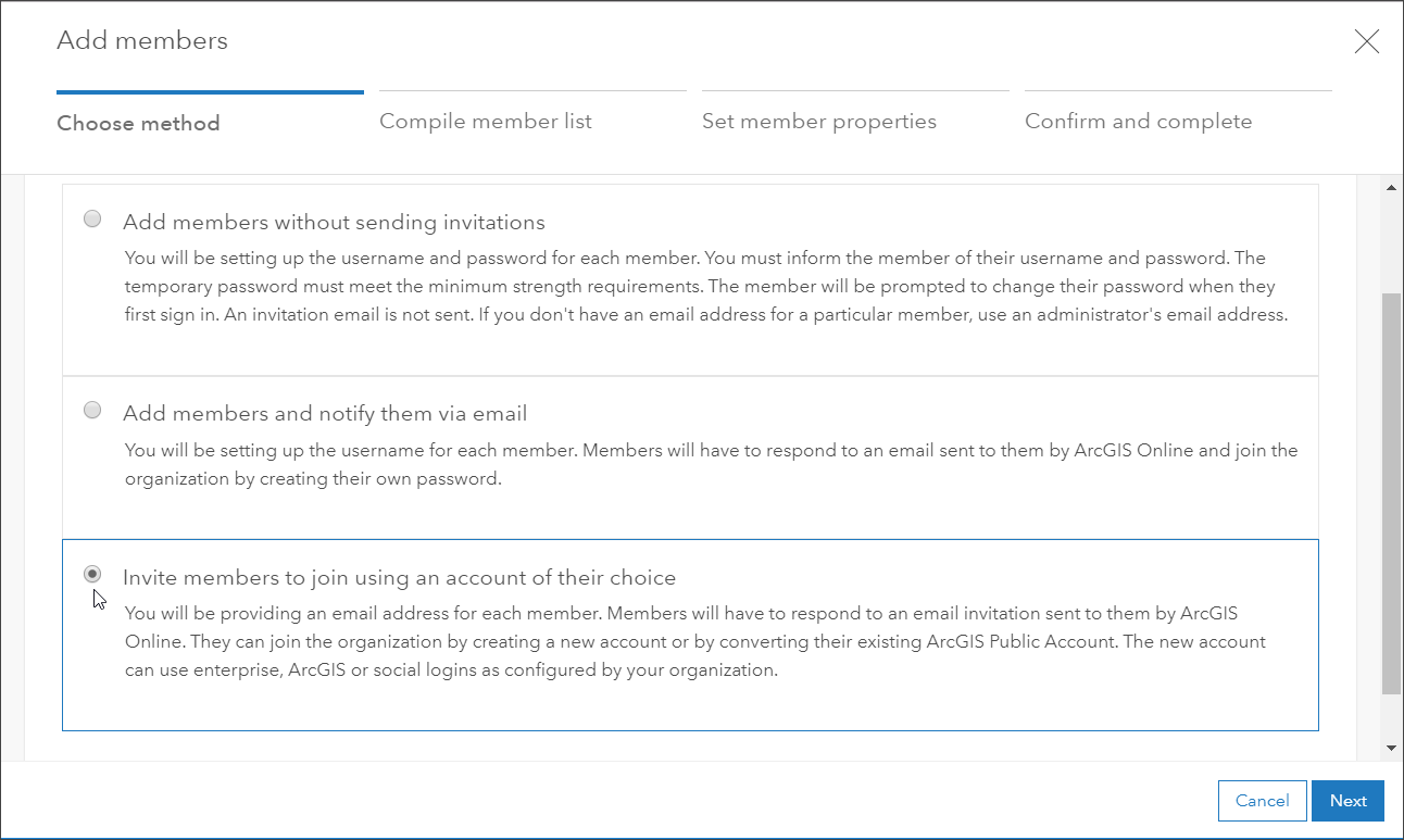

Step 2: Select the method of invitation.
The second step—Choose method—offers three different methods to add members. Choose Invite members to join using an account of their choice, then click Next.

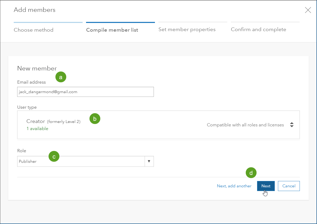

In the next panel, enter the email address of the new member (a) and assign a user type (b) and role (c). Then click Next (d).
![](https://www.esri.com/about/newsroom/wp-content/uploads/2019/02/sociallogins8a.png)

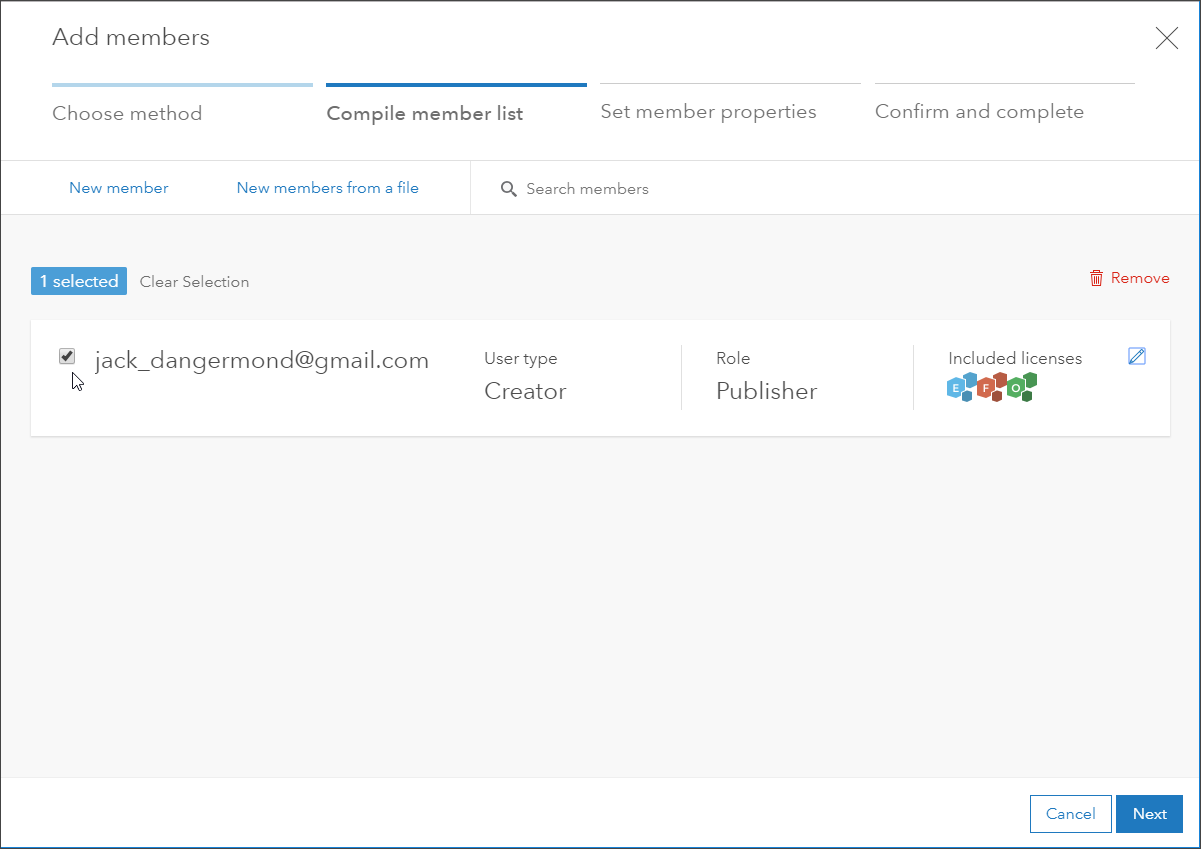

In the next panel, check the box in front of the name of each person you want to invite. Then click Next.
![](https://www.esri.com/about/newsroom/wp-content/uploads/2019/02/sociallogins9a.png)

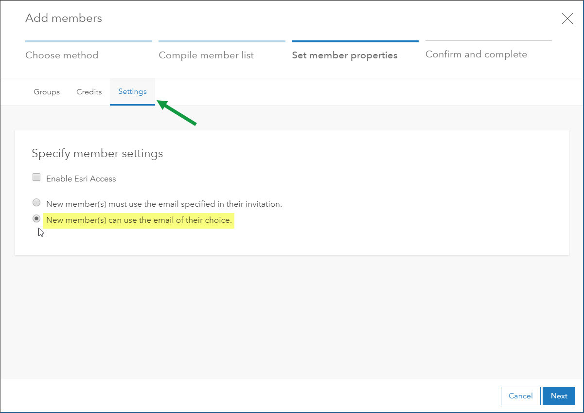

Step 4: Set the member properties.
In the next step—Set member properties—use the Groups, Credits, and Settings tabs to assign default groups, set the credit allocation, and specify the settings for each invitee.
On the Settings tab in Add Members make sure that you have chosen New member(s) can use the email of their choice. Then click Next.
![](https://www.esri.com/about/newsroom/wp-content/uploads/2019/02/sociallogins10a.png)
