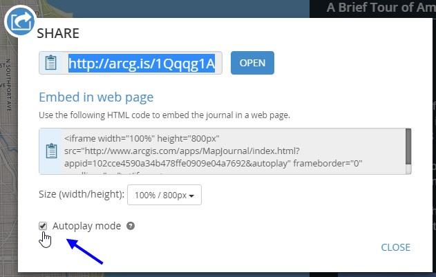

If the story map includes a Share link, you can also enable autoplay by clicking the share link and checking the box.
Checking the box below will add “&autoplay” to both the short link and the embedded HTML file.

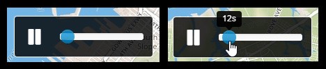

Turn On Autoplay Control
When autoplay is enabled, the autoplay control appears on the story map. Click to pause or play, or move the slider to adjust the time interval.
When paused, you can interact with the story map normally, then click play to resume.
