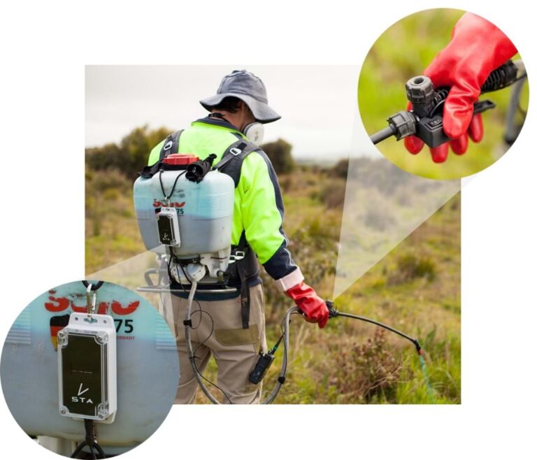

The STA logger attached to a backpack sprayer.
In addition to the Global Navigation Satellite System (GNSS) device that collects location data, the STA logger also has an attachment that connects to the handle of the spray equipment and monitors its activity. When the spray equipment releases herbicide onto the weeds, the STA logger captures the event and records its location.
Recording weed locations on the fly means W+P field operators are effectively doing two jobs at once—mapping and spraying weeds.

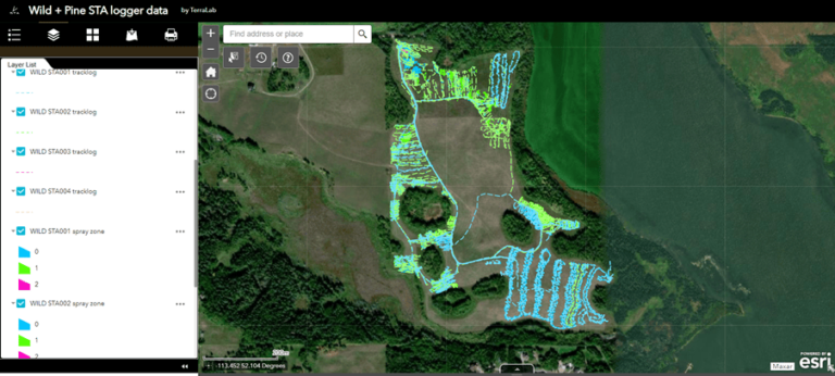

After work in the field is completed, the data is uploaded, processed, stored, and visualized in ArcGIS Online. Processing involves turning the raw data from the logger into three layers. The first layer is a point layer that shows the location of the device every second it is turned on and contains diagnostic information about the device’s status. The second layer is a track log that shows the path the unit traversed while operational, whether spraying or not. The polygon layer, also called the spray zone, represents where herbicide was applied to the ground.
“Before using the STA loggers, we relied on site drawings, written description, and photos to communicate site conditions to clients,” Aubry said. “Spatial elements were rarely included in reports, if ever.”
Processed layers are appended to a hosted layer in ArcGIS Online and shared with W+P through a web application. W+P uses Esri web mapping tools to export data for reporting and compliance.
The STA logger web application displaying the track log and spray zones at Pine Lake.
“We now embed STA logger spatial data into every report sent to clients,” added Aubry. “STA logger data helps us communicate exactly what work we performed on the site inclusive of time, footprints, weed locations, species treated, and spray intensity. We’re now able to provide clients site data so comprehensively that it rivals having boots on the ground.”

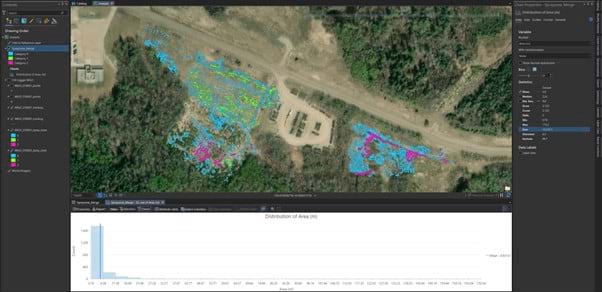

STA logger data is also uploaded into ArcGIS Pro, where the statistics tools and charts available make it a simple process to gain greater insight into this data and leverage it for future reforestation efforts.
For instance, using the tools available in ArcGIS Pro, W+P estimated that in June and July 2021, W+P operators sprayed 1.78 hectares, or 6.5 percent of the site. This is a key output for any organization involved in the management of weeds and can be repeated at set intervals to track a site’s progress over time. Furthermore, it is far more precise and replicable than conventional methods of estimating weed control such as visual appraisal. Users with authoritative data of their site boundaries can use a more accurate polygon and integrate it into automated solutions.
Rapid analysis of STA logger data in ArcGIS Pro.
If a particular set of metrics are critical for an organization or project, the analysis workflow can very easily be developed into a geoprocessing model, scripted in ArcPy, or displayed in a dashboard created with ArcGIS Dashboards.
A host of statistical outputs can be applied to STA logger data using ArcGIS Pro. Some statistics commonly assessed by STA logger customers include the distance operators travel in a day, the area they spray per day, the ratio of distance traveled to an area sprayed, and the number of trigger presses per unit area (as a proxy for planted tree abundance). Whatever metric is important to weed managers, STA logger data serves as a first step.
