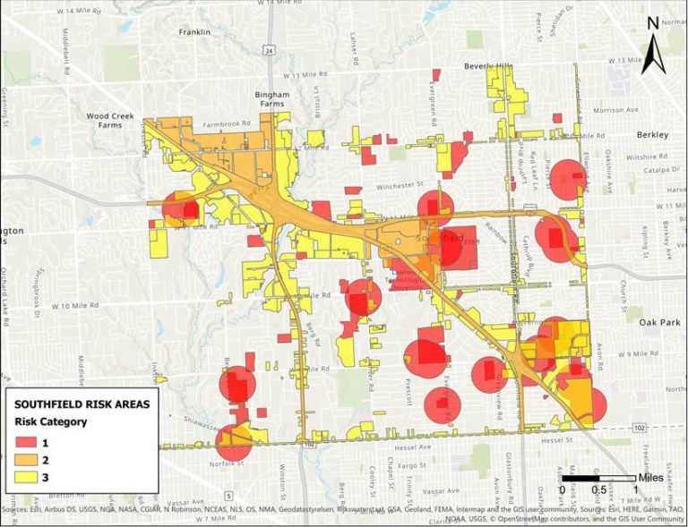

What would happen if a 20-pound drone, plus payload, crash-landed in your community? The wealth of GIS information generated by cities can help answer questions like this one. Land use, land cover, slope, building footprints, street centerlines, school locations, and other GIS data that cities maintain can be used for drone risk analysis.
Some cities utilize computer vision (the ability for computers to see) or remote sensing processes to conduct urban analysis projects. For example, using artifical intelligence (AI) and GIS, workflows can be developed for calculating the number of vehicles in a parking lot to estimate how many people are in the area at a specific time, which could inform risk analysis for operating drones over specific locations.
As drone egress and ingress locations proliferate, GIS will help community officials place and approve individual or common landing hot spots. Regulating these locations may rely on a process of permitting that incorporates automated approval/denial decisions based on risk data, visual inspection, and operation verification to help satisfy safety requirements. GIS already plays an important role in existing permitting workflows, and the progression into UAS infrastructure will be a natural extension of this process for many communities.

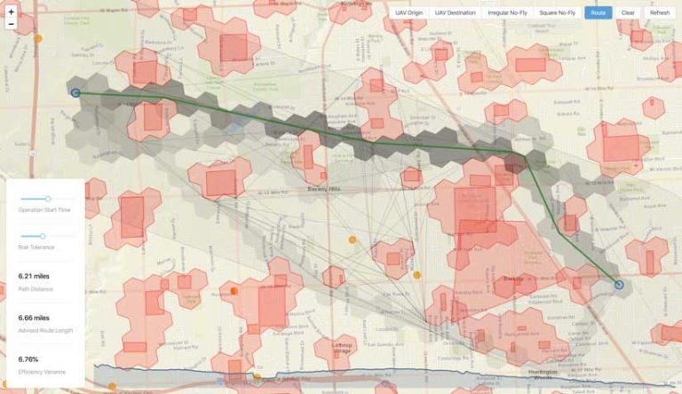

Perhaps the gold standard many drone technology evangelists are working toward is the operation of drones autonomously or remotely from the pilot’s location. Known as Beyond Visual Line of Sight (BVLOS), these modes of drone operation are not allowed in most regulated environments. A better understanding of the types of paths a drone would take if left unmonitored is required before these restrictions will be lifted.
By most measures, an “as the crow flies” path is usually the optimal one for any given drone operation. This is especially true with limited onboard battery storage. Dynamic variables, such as weather, can make total battery life unpredictable. Unfortunately, a straight-line path is not always the safest path, and safety must be the controlling factor for mission planning.

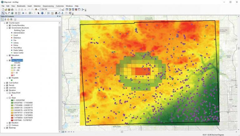

Utilizing community data, raster analytics can be put to work to generate BVLOS risk analysis for drones. Part of this analysis is deriving a cost surface. By chaining together raster functions (image processing algorithms), a data product can be derived that represents the cumulative risk for operating drones over specific geographies based on datasets provided by local government.
A cost surface empowers decision- makers and automated systems to calculate the optimal travel path over the length of the planned mission. Given any origin and destination, this path will have the least accumulated risk. This capability will enable use cases such as point-to-point delivery, remote inspections, and “drone in a box” (i.e., drones launching autonomously from remote charging stations).
