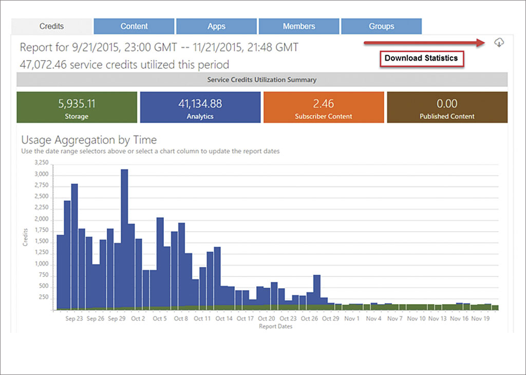

2. Generate Statistics
Use the View Status dashboard to monitor the activity in your organization. You can filter credit consumption activity over time and export statistics so that you can work with it in a spreadsheet. This is useful for identifying any spikes in activity so that you can take action, either by reaching out to users or even disabling accounts.

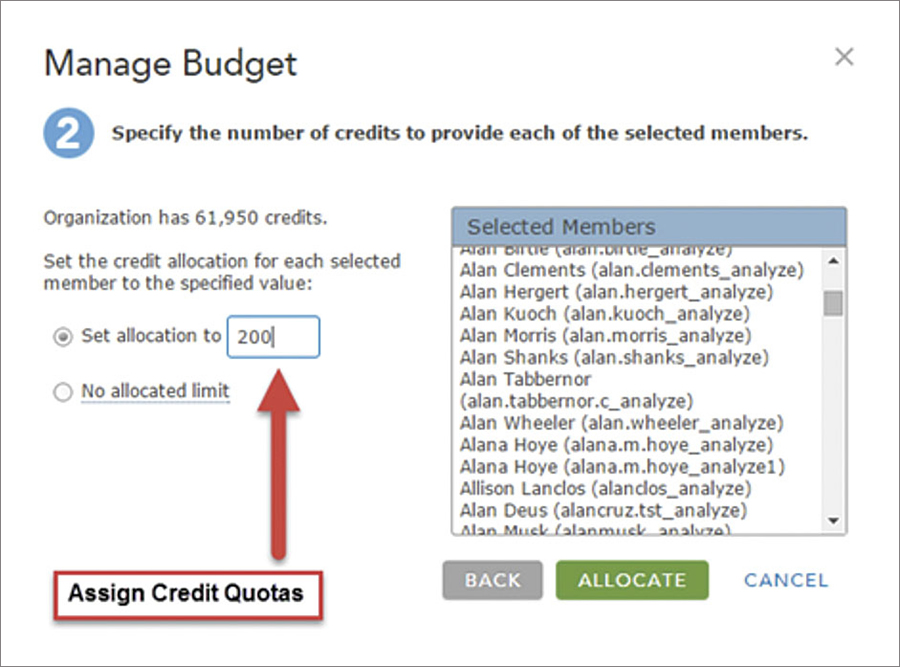

3. Assign Credit Quotas
A new administrative tool for assigning credit quotas is extremely helpful in keeping your organization’s credit usage in check. You can assign credit limits that apply specifically to tile generation, GeoEnrichment, geocoding, and analysis services. Credit quotas do not apply to item storage and limits can be adjusted at any time. Credit quotas can be assigned to groups, roles, or individual users. When a user reaches the predetermined credit limit, that user will still be able to access content but won’t be able to use the services previously listed until an administrator assigns a new quota of credits.

Allocate more credits to the user using the workflow shown in the online video ArcGIS Online Budgeting and Allocation. Instead of searching for the user by group, you can search by name and assign more credits to a specific user who has exceeded the set limit.
How many credits can I allocate to my users?
When managing your credit budget, you can choose to give them access to the organization’s total allotment of remaining credits, or you can set a limit for each user of any value up to that figure. Allocations may be modified at any time.
Note: The total of individual credit budgets may exceed your organization’s total number of available credits. For example, if I have an organization with five users and 1,000 credits, I can set individual budgets of 250 credits, which would total 1,250 credits. This is possible because individual and organization credit limits are managed independently. The budget prevents any one user from spending more than 250 credits, but ArcGIS Online treats all organizational credits as a pool. If the organization still has credits available and a user has not reached the assigned credit limit, more credits are available to the user.
