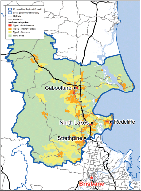

The Moreton Bay Regional Council (MBRC), a local government area in Queensland located north of Brisbane, is Australia’s third-largest council, with an area of 206,944 hectares (ha), or 511,369 acres. With approximately 400,000 people (per 2011 Censuses of Population and Housing), it also has one of the fastest-growing populations in Australia. The MBRC population is estimated to grow to 516,000 people in 2031.

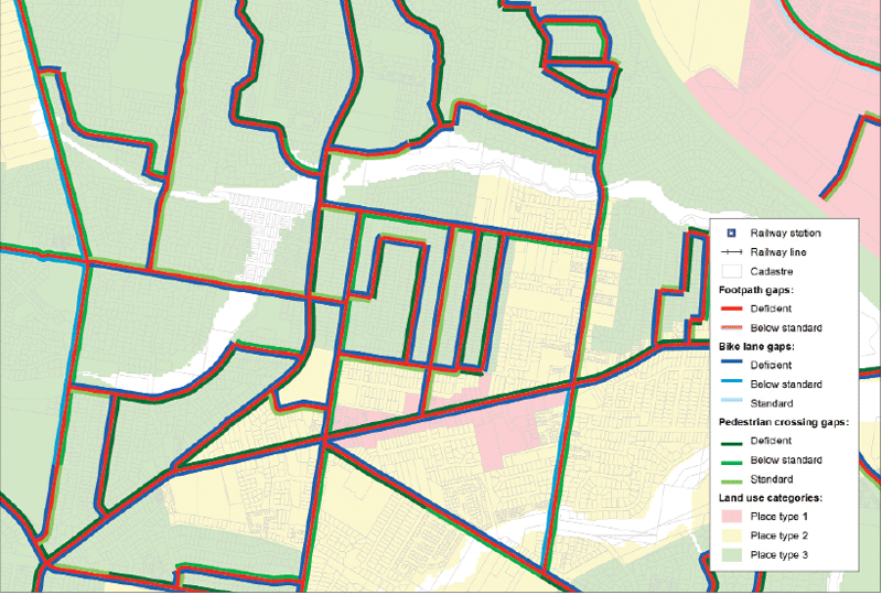

The first step in determining the required upgrades of the active transport network was to audit the existing network. This involved dividing the road network into 1,690 individual segments. Using the road reserve polygons in the cadastral database, each road segment was given an area. All features within this area were classified as part of that road segment. Features outside the road reserve were excluded.
Once the segments and extents were determined, the network audit calculations gave summary figures for the existing network. Using the Analysis Tools geoprocessing tools in ArcGIS Toolbox, the active transport networks were documented for each road segment. This resulted in 80 separate attributes that documented the active transport network for each of the 1,690 road segments. For each road segment, all 189 attribute values were collated or calculated to create a comprehensive database of information on the active transport network for the Moreton Bay Region. Creating this database provided the basis for performing the network analysis.

To create realistic standards, urban land uses were divided into three categories: type 1 (activity centers), type 2 (intensive urban), and type 3 (suburban). Standards were developed for each category. This step allowed the analysis to produce realistic results based on the intensity of the land use.
The gap analysis involved comparing the results of the network audit with the desired standards to determine the quantity of each active transport element. Areas were classified as follows: those that met the standards were deemed at standard, those with active transport elements that did not comply with standards were classified as below standard, and those with no active transport infrastructure were deemed deficient.
The results revealed that most of the active transport network would benefit from upgrading. The active transport facility benchmarks set for desired levels of service would ultimately create a more active and connected community.
