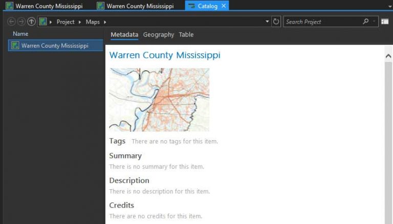

You will use the Catalog view while updating metadata. It displays a details panel with the current metadata for the map. Since you just discovered that the map has no metadata defined, it would be useful to add a summary of the data layers and a description of the symbology and coordinate system used for the map.

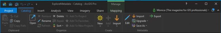

- With the Catalog view open, click the Catalog tab in the ribbon to see the Metadata group. This group contains functionality to edit, import, export, and upgrade metadata.
- In the Catalog view, click Geography.
- On the ribbon, click the Preview tab, and use the Pan and Zoom tools to update the display extent to Warren County.
In the Preview group, click Create Thumbnail. - In the Catalog view, click Metadata to review the updated thumbnail in the Details pane.
- Next you’ll edit the map metadata. On the ribbon on the Catalog tab, in the Metadata group, click Edit. The Metadata editor pane displays.

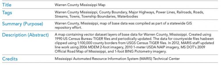

- In the Metadata editor pane, add the information listed in Table 1.

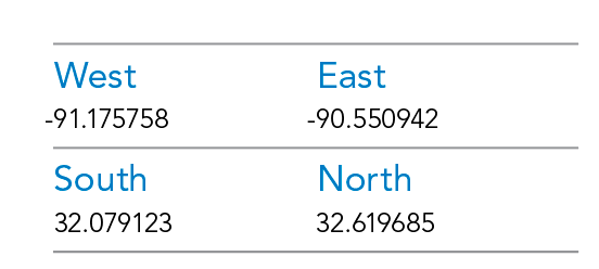

- Set the minimum Appropriate Scale Range to 1:500,000 and the maximum to 1:5,000. Click New Bounding Box. For Bounding Box, click New Bounding Box and type the coordinates in Table 2.
