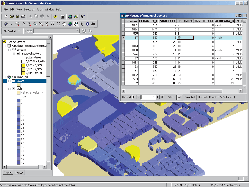

click to see enlargement
The distribution of Islamic pottery shows a localized concentration because shards of broken vessels, rubbish, and other debris were put in pits. The attribute information for pottery shards was made available from tables that were joined to shard locations.
In summer 2002, a GIS application was developed for the project. The application works on an Intel Pentium 4 computer with a 2 GHz processor and 256 MB of RAM running Microsoft Windows XP. It was created in ArcGIS 8.2 and uses the ArcGIS 3D Analyst extension. The stratigraphic unit (SU), the smallest unit recognizable during archaeological excavations, serves as the key for topographic data acquisitions and the relational database. Each SU has a numeric keycode that addresses the analytical data or classification.
