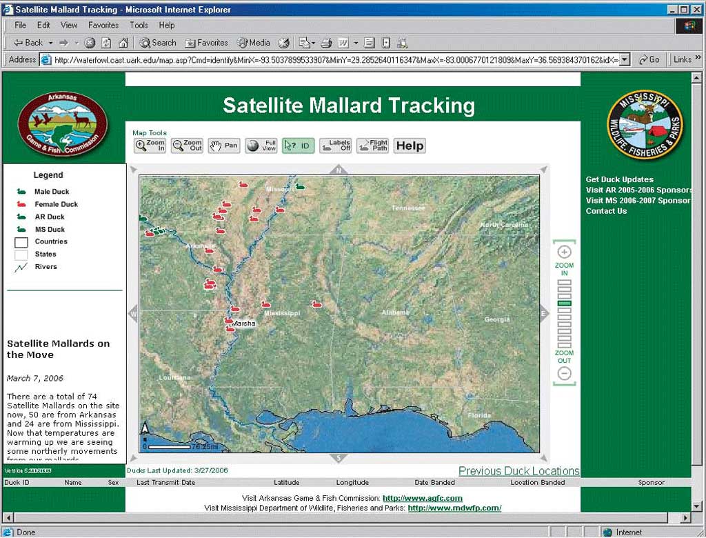

The Satellite Mallard Tracking program (www.agfc.com/mallards/), developed by the Arkansas Game and Fish Commission (AGFC), lets biologists collect valuable migration routes and breeding location information for mallards that use the Mississippi Flyway. An ArcIMS application that shows the movements of ducks in near real time provides an exciting way for the public to be involved in waterfowl management.
The Satellite Mallard Tracking program lets biologists collect valuable migration routes and breeding location information for mallards that use the Mississippi Flyway.
Mallard ducks captured in Arkansas during February and March are fitted with platform type transmitters (PTTs). PTTs acquire and transmit locations at preprogrammed intervals. After these location transmissions are processed, reliable locations are automatically posted to the ArcIMS site where biologists and users may track the ducks' migration. This application answers the oft-asked question, "Where are all the ducks?" Tracking mallard migrations via the Internet has become increasingly popular with sportsmen throughout the Mississippi Flyway and AGFC biologists since it was first made available in late November 2004.

After AGFC decided to create an ArcIMS site for tracking the mallards, the Center for Advanced Spatial Technologies (CAST) was contracted to design and develop an automated ArcIMS site that would require little manual interaction. CAST and AGFC worked together on the Web site portion of the ArcIMS site.
