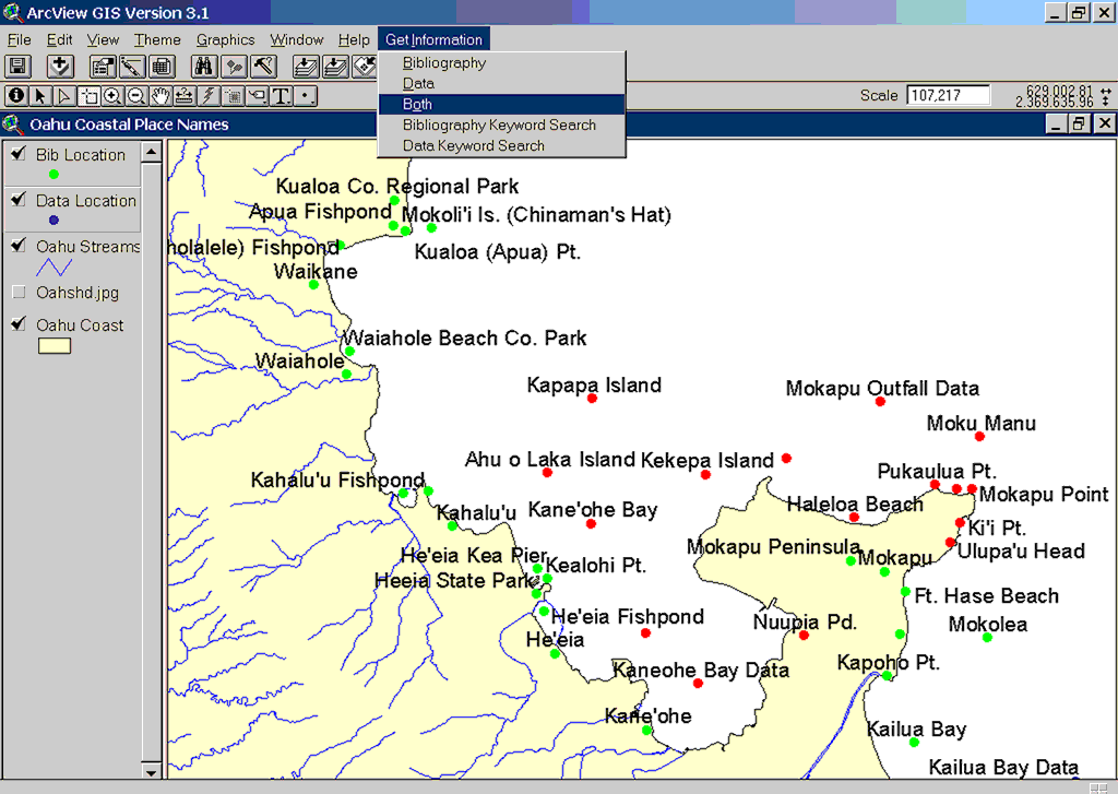

click to see enlargement
Information available for selected locations (shown in red) is retrieved using menu selections.
