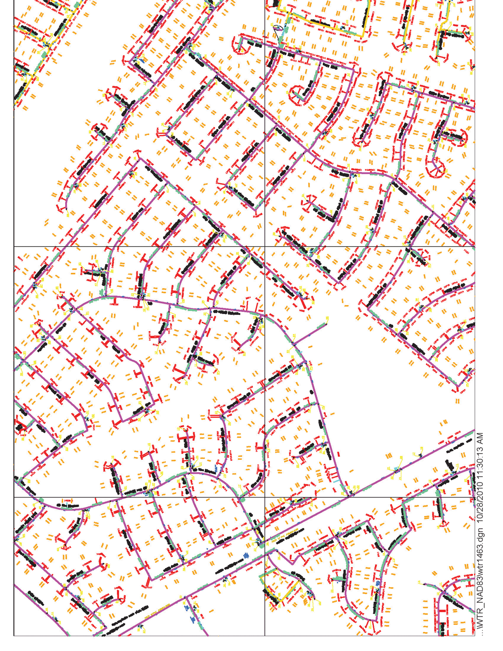

a MicroStation-based water/sewer map layer
The GIS team converted hundreds of MicroStation-based water/sewer map layers, such as this one, into GIS-based, spatially accurate map files that support the asset management system.

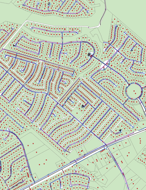

one of the maps created
One of the maps created after the team reviewed hundreds of MicroStation maps, attribute layers, and account tables to tie asset locations, attributions, and customer service points to 500,000 addresses.

An intense, daily effort began to untangle and weed through hundreds of MicroStation map and attribute layers and account tables to tie asset locations, asset attributions, and customer service points to their correct addresses—all 500,000 of them—one point at a time.
Every tabular address field had to be converted into a geographic location on a map. "Address points had to be on the correct parcel where they belong, and service points had to match the actual service location of their meter or sewer connection," said Phillips. "We had to validate and correct every one of those points, and we were doing this manually, one by one, for half a million points."
