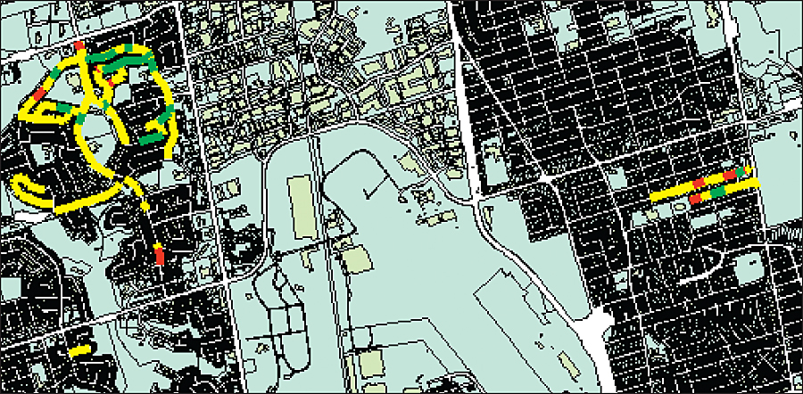

In this view of the City of Toronto, the colored layers highlight the status of the assets. For example, yellow pipes have already been inspected, green pipes require cleaning, and red pipes are in danger of a possible collapse.

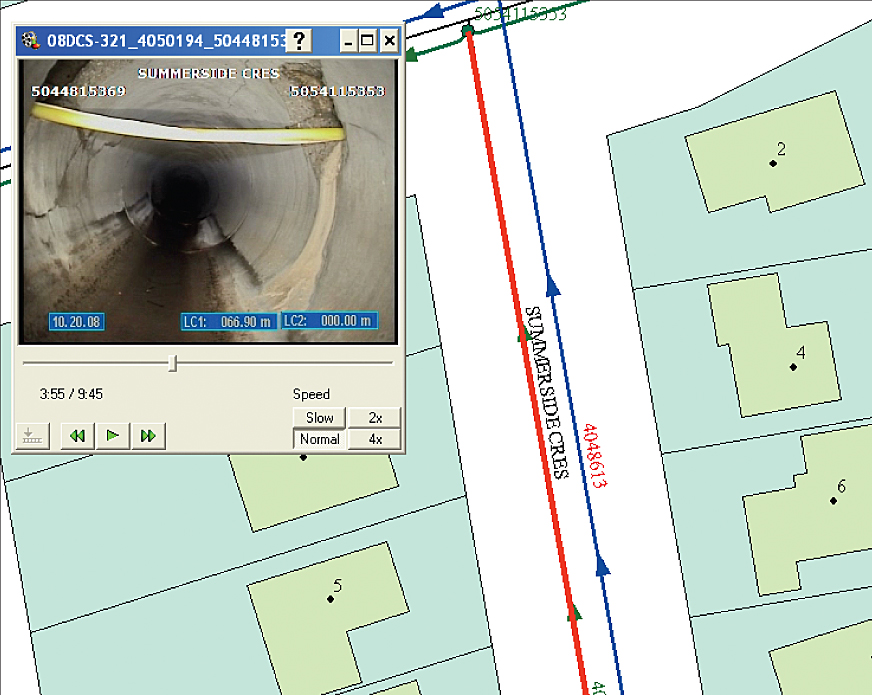

In 2008, after a successful pilot project, the city commissioned CTZoom, a Montreal, Quebec-based firm and Esri Canada Limited Business Partner, to install industrial inspection computers running its asset management software—CTSpec—in closed-circuit television trucks across the city. CTSpec is a data collection and analysis tool that leverages ArcView to provide a spatial component to infrastructure maintenance. With the software's video feature, users can now click an asset within ArcView to pull up a video of that asset.

But now, the city's new infrastructure maintenance program has strengthened city inspectors' ability to manipulate data. Inspectors and contractors just click an asset, and a header box pops up containing the desired information, such as name, location, and work required. They can quickly view a video and accurately assess inventory assets, and CTSpec also includes an automated tracking service that updates the status of asset conditions. The inspection unit's computers are synchronized with personal digital assistant (PDA) technology so that Toronto Water contractors can complete manhole and pipe diagnosis on handheld devices directly into a GIS that is easily shared with other contractors throughout the city.

The inspection application's video feature lets users simply click on an asset within the GIS to pull up a video of the asset.
The infrastructure maintenance program can now output ArcView software-based, multilayered digital maps that make it possible to proactively plan infrastructure maintenance activities. For example, a yellow layer identifies pipes that have been inspected, a green layer presents the operational performance grade of the pipe (the extent to which the pipe requires cleaning), and a red layer provides the structural integrity grade of the pipe so that inspectors can predict the likeliness of a collapse.
