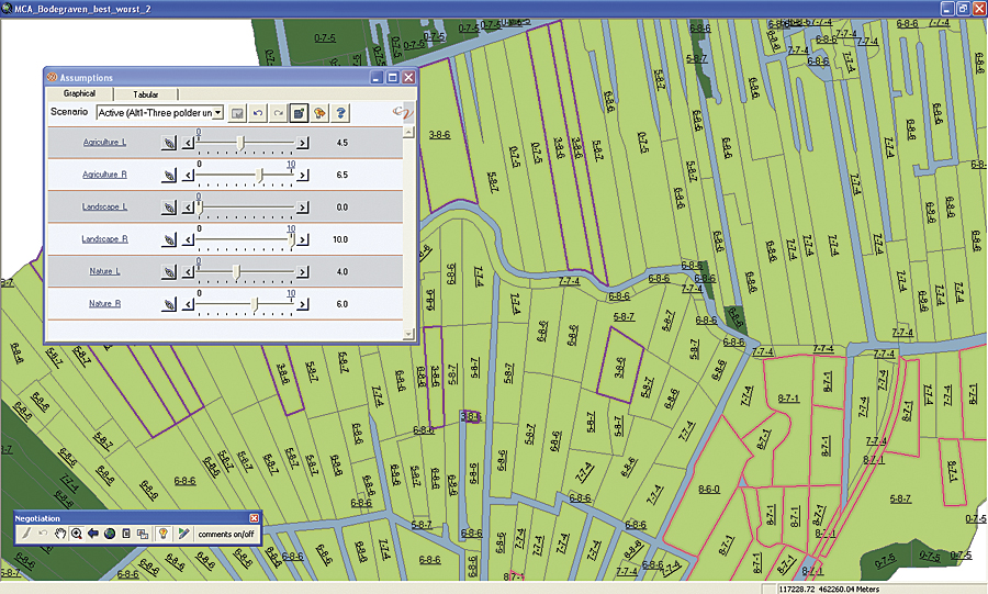

Quantitative trade-offs of the project were identified by selecting polygons that would profit from a land-use swap based on their actual MCA value.
The touch table supported stakeholder participation in the workshops and acted as the main map interface for the geodesign software. A separate screen was also set up to view additional information, such as charts and tables. In the analysis workshop, the project team used ArcGIS to present maps with thematic information about the region to increase the understanding of participants, who included both experts and stakeholders with varying backgrounds. Next, the project team used Scenario 360, a component of CommunityViz, to create scenarios. Each scenario consisted of a polygon-based suitability map in which the weights of each criterion were set according to participants' values. Participants could change the weights interactively using the touch table to adjust assumption settings in the software.
As the weights were changed, the results were dynamically updated and presented both on the touch table as a map and on the separate screen as a bar chart showing aggregated scores for various criteria and objectives the participants had established. A set of weights and the corresponding set of value maps constituted the main product of this phase. Ton Verdoorn, a project manager from the Province of South Holland, remarks that the combination of GIS and planning tools made it "possible to quickly and clearly see both spatial and numerical consequences of changing variables on the map."

The negotiation workshop supported the process of collectively changing the current land-use pattern of the polder into a new, negotiated plan. Participants were the institutional stakeholders: the water board, the City of Bodegraven, the Province of South Holland, and nature conservation organizations. To support negotiation, the project team used multicriteria methods to show trade-offs among stakeholder objectives. Stakeholders used Scenario 360 to adjust two kinds of trade-offs: qualitative and quantitative. Qualitative trade-offs were identified by selecting polygons that were "very suitable" or "very unsuitable" for each potential land-use type based on their summed area and ranked multicriteria analysis (MCA) value.
Quantitative trade-offs were identified by selecting polygons that would profit from a land-use swap based on their actual MCA value. The next step was to change the plan. Stakeholders used their hands with the software's sketch tools to change land-use patterns on the touch table as they discussed the changes. A land-use palette allowed participants to assign new land uses to target parcels. As soon as the participants agreed on changes, MCA results were updated and displayed as bar charts on a separate screen in real time.
