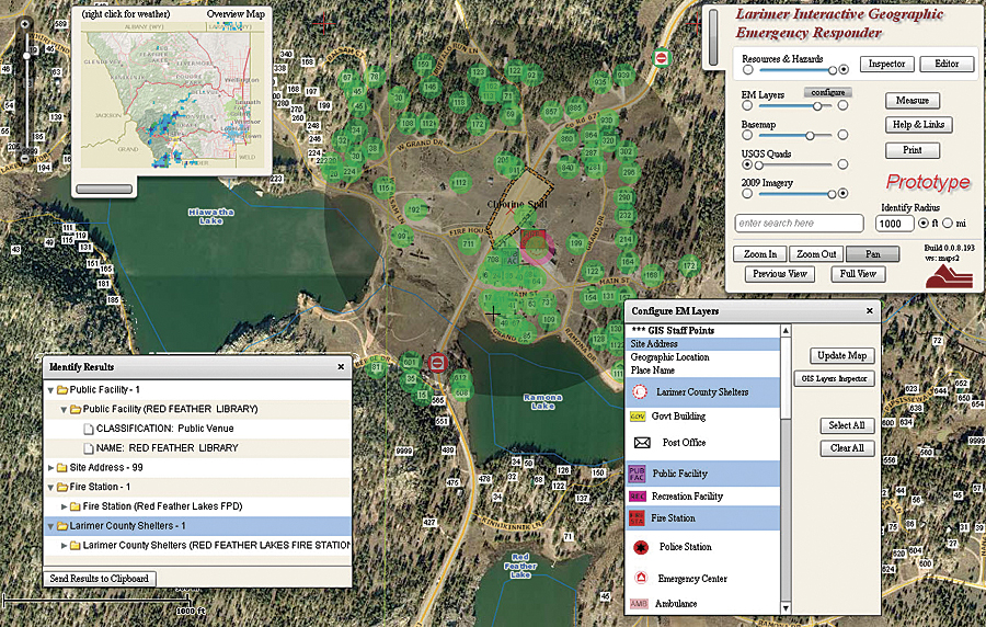

Larimer County GIS (LCGIS) stores a wealth of spatially enabled data, from site addresses to county shelters to critical infrastructure, such as schools, public facilities, and police and fire stations. When coupled with census and derived Federal Emergency Management Agency (FEMA) HAZUS-MH layers, a rich, queryable tapestry becomes readily available. Map visualization provides a holistic overview of the incident, while actionable reports come from performing spatial queries.
Infrastructure and population layers can be queried to produce timely reports on vulnerable assets.

LIGER provides a means for emergency managers to always be in touch. When users load LIGER into their web browser, they are presented with a sign-in form. This information persists on the PC and server, and the user can bring up the LIGER status window for contact information on all parties currently using the application. LIGER automatically either logs users out when they close the application or changes their status to "away" if they engage in other computer activities. LIGER allows single-click, as well as more complex, buffer queries for a fast, summarized listing from critical infrastructure layers. This information can be copied to the clipboard and pasted into a spreadsheet or e-mail.
Resource Allocation Relative to Hazards
LIGER empowers the emergency manager to quickly sketch the evolving response effort in real time. Resources can be placed on the map with corresponding levels of readiness, creating a dynamic, collaborative "chessboard." EM staff can update and manage resources as needed while the non-EM audience follows along with read-only instances of the application.
Very large incidents can be visualized and managed in this way so that as the response effort proceeds, resources on the map turn from red (needed) to yellow (allocated) to green (in use). Local government officials can monitor the progress of the incident response simply by bringing the application up on a PC or projecting it on a wall and setting it to autorefresh.
