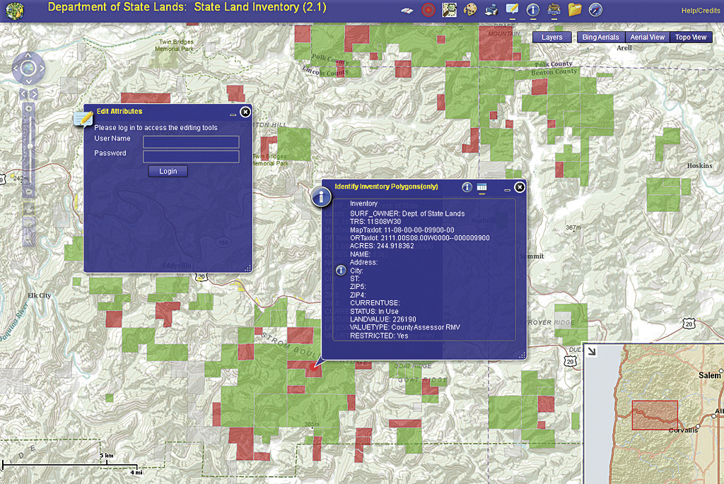

When working with proprietary datasets that have restrictions, all editing should require that users be assigned privileges and recognized through special authentication. This is especially true when editing datasets online in web browsers. The base Edit widget was modified to allow online editing through an authenticated approach. The user first authenticates into the system, which starts a selection process similar to that used in ArcGIS for Desktop. This ensures that only authorized personnel can modify their agency’s records in feature layer attribute tables.
The State Land Inventory application facilitates online editing through an authenticated approach so users can only edit data from their agency. This eliminates any chance that changes could be implemented by unauthorized personnel. Personnel from each agency can log in to the online application and make real-time edits to geospatial layer attributes in an easy-to-use web-based environment. This increases efficiency by eliminating involvement of specialized personnel trained in GIS in the workflow and reducing overall staffing cost.

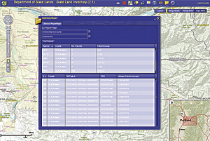

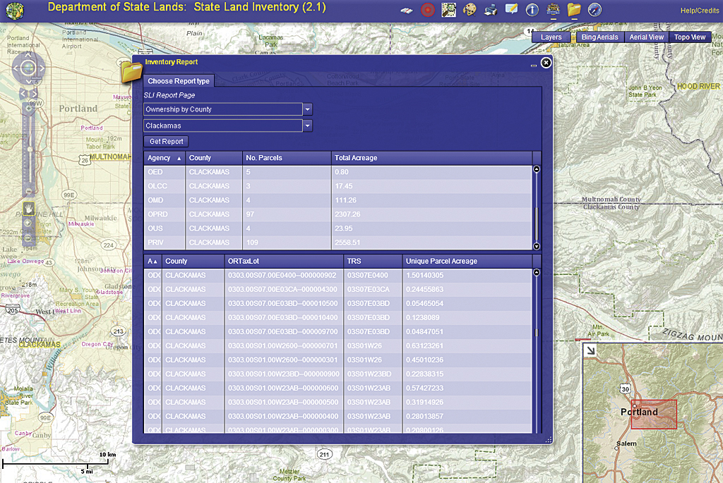

Easy-to-Generate Reports
Several agencies wanted the application to generate online agency reports of surface ownership derived from queries against attribute tables for multiple layers. This is easily done by selecting the appropriate type of report desired and clicking the Get Report button. This runs a number of queries against an attribute field, and the results are displayed on the same screen near the bottom of the scrollable and resizable window. These results are helpful because queries are run against both agency boundaries and legislative districts throughout Oregon.
